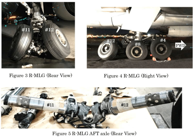

Lest we take SCC too lightly, though, there's an accident investigation report in my newsfeed today:
Admittedly, that axle is made from steel and has probably been in service for a while.
