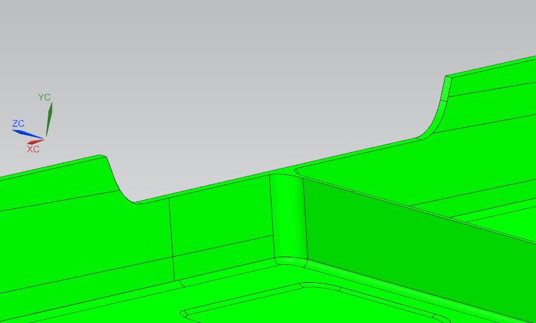

I have a model that was stepped out of Catia. One side is made of a bunch of surface patches. I need to make some changes to some cross ribs. Synchronous modeling only handles a few of the needed changes. In some areas I've had to extract surfaces, trim them, thicken and then "glue" them in.
This has worked for other areas on the part excepting one. I get the "patch" created but when I do a boolean unite it adds it to the tree but the "patch" is invisible. If I change the thicken by .0005 either under or over it fills the opening.
There isn't enough data to recreate the model so that isn't an option. My method is rather Flintstone-ish I know I couldn't get anything else to work.
Anyone have suggestions on my invisible patch?

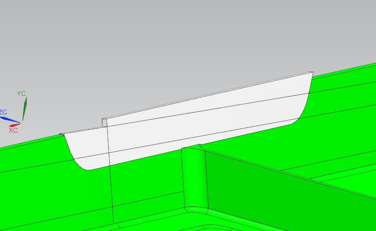

These are the model before "tapering", the inside after unite, the outside after unite.
The .0005 difference seems to be controlled by the default tolerance of .004 in the boolean drop down. I changed it to .0001 and then the thicken to .1201 (wall is to be .120) and these pictures show what I have. this is a tough area to edit, as you can see from the outside pic there are 5 surface patches converging.
When I tried to change it via synchronous modeling I get errors regarding a b-surface that won't move to close the gap.

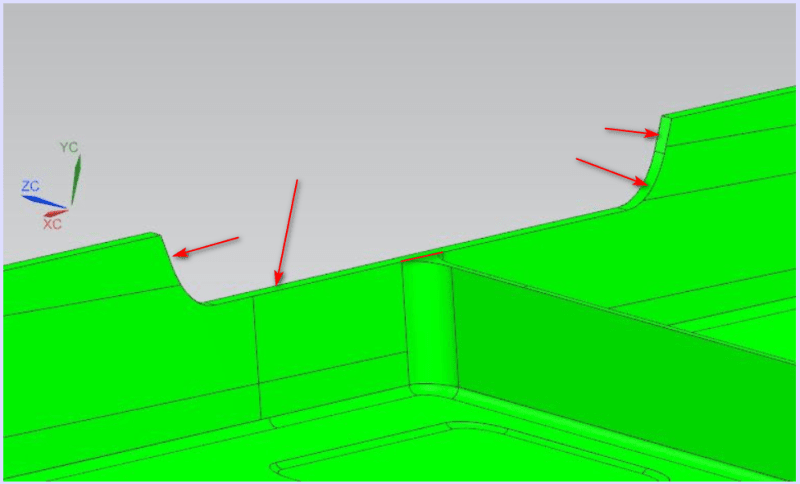

On the top picture it looks like all the faces shown below are on the same plane.
Is this the way it is ?

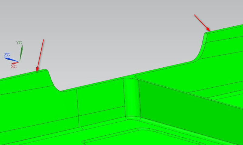

Try to make these faces co-planar first
Then see what happens if you split the surface at the blend and then delete the faces (Arrows)

Your suggestion didn't quite work but you did put me on the path. I used replace face to join some of the common faces, then in the move face dialog, turned on all the features under settings. The face moved and updated.
Thank you and Jerry for your replies and suggestions. Hopefully I'll be able to pay it forward.
