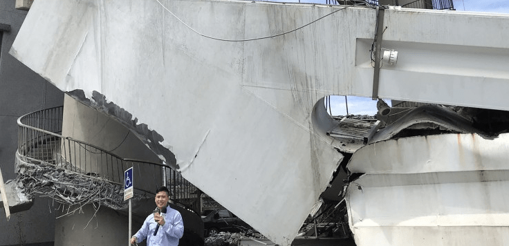

image from other article shows weld seams and tearing of the structure

Least what's left seems fairly intact. Especially the arch, so I'd think if failure initiated there as videos suggest it would be fairly easy to establish initial cause.
Since the arch is steel then I'm guessing their must be a hatch and an internal passage for inspection and maintenance of the stay anchors. That would have to be there for the original installation I think. There is even a ladder in the @IRstuff photo but I suppose that could just be for changing the light bulbs.
The arch itself is intact, but it came adrift from the wishbones. In addition to the hangers and their attachments, the joint at the arch and wishbone should be investigated. Probably the connections to the abutment as well.
