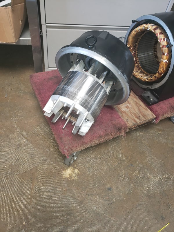

AC Motor shaft sheared

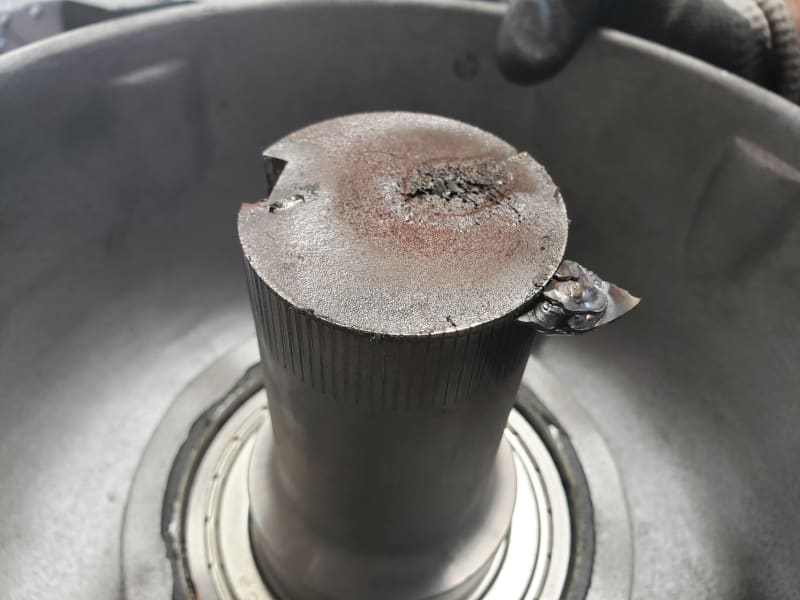

Tossing out a guess, it appears to be an [overhung load with rotational bending] fracture... based on the photos posted of the shaft break.
What is the motor's application? Is it a belt drive arrangement by chance?

OK thanks, that worked, as did the close-ups. Thanks!
Yikes. I see what you mean. Not clear on what we're seeing though. Is the bottom picture the shaft having left the rotor and heading into a machine (pump)? What kind of load is the shaft driving would help with the possible answers.
Typical shaft breaks are like this. Something stresses the shaft and then the stress fracture moves across the shortest path until the shaft fails. I could see the HAZ from welding the fan on being the precipitator.

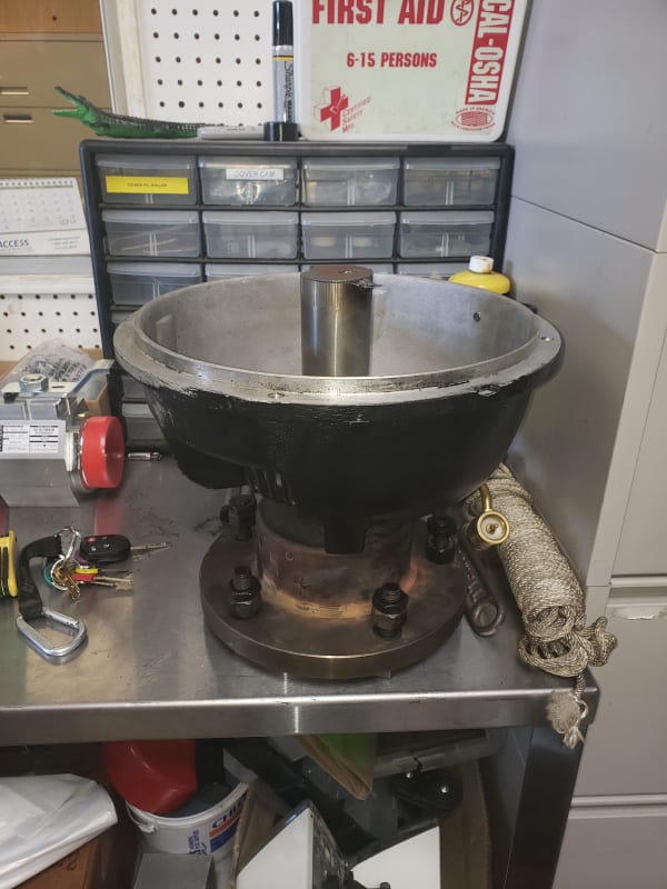

The shaft sheared right going into the rotor. The other picture is of where the shaft goes out of the housing, and that flat end is what was attached to the rotor. It's a hydraulic elevator pump motor. As for the welding marks, have no idea. Was purchased as a new motor. Almost looks like it was "welded" to the rotor. That is almost too flat a fracture.

OK, made a mistake. Motor was from a traction elevator. Couple more pictures to offer different view
First picture shows where the shaft is attached to the flange that couples the motor to the brake.

I'm wondering if the shaft failed or even just cracked a long time ago, and someone decided that rather than replace it, they would weld it onto the rotor, as in "We can't have the elevator be down for weeks waiting for a new motor from Rueland, so weld it for now and we will order a replacement and put it in when it gets here...".
Then some bean counter said "Is it working now? Yes? Then no need to spend money on a new one..."
Side note: now that we know there is a mechanical brake, it's likely that there is something wrong with the brake system. Elevator motors must have very heavy duty brakes capable of stopping a fully loaded elevator in free fall. If the brake engages while the motor is still energized, you can definitely break the shaft.

Looks like a fatigue failure to me, I can see river lines going radiating from the large dark area which have may of been a flaw in the shaft.
I'll do some digging and post later.
RE: AC Motor shaft sheared
I'm a little confused, the first and 2nd pictures are both halves of the same break, right?
The 2nd pic shows a keyway.
I don't see the same keyway in the 1st pic. Is it hiding there at around the 6:00 position? Is the shaft keyed to the core? Why would the keyway extend beyond the core?
I guess there was welding between shaft and core endplate at 12:00 and 6:00 positions to prevent core migrating axially on the shaft? Seems to have deteriorated, any idea why? (maybe during the failure).
The plane of the shaft failure seems to be about 1/4" into the core.
What is the purpose of the evenly spaced axial grooves along the shaft? I'm not familiar with it. I get the wild idea that may have been done because they had difficulty assembling and this was easier than remachining the diameters to reduce interference / increase clearance.
Based on the odd location of failure my wild first guess fwiw is there is a manufacturing related stress riser of some kind. I didn't read the other responses closely, I apoligize if I ignored better answers (I don't think I'd know the right answer if I saw it in this case).

Pete; Now that you mentioned it, take a close look at the 6:00 o-clock position.
I think that I see a keyway with a key still inserted. Not sure.
I suspect that whatever the cause, the welding stress may have contributed to the location.

Gold line start and crack propagation direction.
Red circle is the last bit holding that actually got twisted off.
Note on the terminating end of the gold crack where the shaft was punched in as the shaft bent on separation. The twist-off would happen at the 'last end' of the crack failure.
My theory anyway.

Thanks Keith. I didn't see that view before - now I can see there is the key sticking up at 3:00 in that photo. The top of the key is rounded and the key is welded to the core and the shaft. Please disregard all my questions about the key and keyway.
IF the propogation is in the direction you say (*) THEN it started in the vicinity of that keyway / weld.
(* however, I think I can see beach marks running parallel to your arrow and I thought the failure propogates perpendicular to the beach marks ),
(2B)+(2B)' ?
Nice picture Keith. I have suspected that the shaft was keyed to the rotor core as well as the press fit.
Suspicions are stronger now.
Marke and I have both suggested that the shaft was weakened by the welding and then suffered a torque event. Either by a re-closer event or by Jeff's suggestion of inappropriate breaking.

One more data point, the inside corners of the key way do not appear radiused.
I have no reason to doubt what Keith says. But if I were investigating at our plant, I'd give it to our degreed metalurgist who dabbles in failure analysis part time. I've done that before and he comes up with some remarkable subtle observations which I would never have noticed or understood, based on both the macro appearance and the under-the-microscope appearance. We're lucky to have him.
(2B)+(2B)' ?
fwiw, my best swag based on attempting to read beachmarks (which are perpendicular to direction of crack propagation) is that the cracks initiated on the inside corners of the keyway, rather than the weld (although view from the other side of the key hidden in this photo might be different). Again, I'm no expert and I would trust a knowledgeable person with closeup inspection far more.
(2B)+(2B)' ?

Noting the requalification of the motor being from a "traction elevator"... is the output shaft
driving a pulley, or is it directly coupled? (I may have missed that answer if it was given.)
On the knurling:
Knurling is an economical way of creating an obstructing fit between the rotor laminations and shaft.
This type of fit relies upon raising the shaft surface metal to compensate for the shaft diameter being undersized for the hole it's mating with.
Hence, the additional necessary application of weld(s) in this instance... to keep the rotor in its proper location.
Typically this type of assembly is found in much smaller horsepower arrangements.
Knurled shaft fits on larger motors are usually confined to cooling fan fits, etc.
As Marke suggests, the weld points could have contributed to creating stress points,
"but" typically weld points like this are found on many motors in industry without any adverse effect.
Another observation related to the motor's design:
It's not very often the rotor/shaft portion of an electric motor is SMALLER in diameter than its working output shafts.
(They are out there. A soaking furnace motor comes to mind to name one example.)
In looking at the re-attached photo from earlier in the thread, note how the rotor is
mating with a shaft that is smaller in diameter than what is passing through the light duty
6200 series bearing heading toward the brake.
Consider how much more robust the rotor portion would be if the shaft remained the same diameter or slightly larger than the brake output shaft end.
The shaft failure appears to be "text book" rotational bending.
At this point, it's conceivable that an identical motor could be reinstalled for service, and
within a period of time have the same failure.
If a new shaft was made to replace the broken one, it would serve greatly to make it a "keyed"
press fit that would bottom against a shaft shoulder and not rely upon a couple of spot welds.
With this being a somewhat OEM motor failure, I'd suggest more input from the manufacturer
of the equipment, and the maker of the motor to learn if there is something amiss here.
