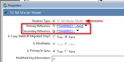

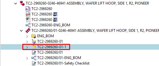

I would like to learn about the method you speak of. The above program has worked flawlessly except for one part that I have changed the name many many times and it still will not work. The above program seems to be pulling them from the name shown in red below. How can I find out which relation is used?

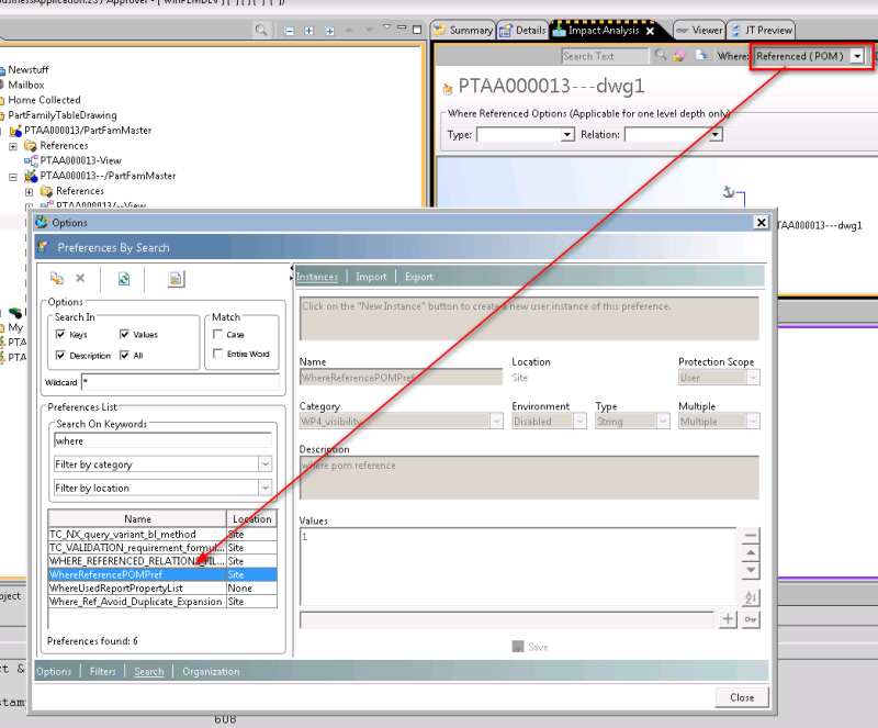

You can find the relation using Impact analysis in Teamcenter.
Check if you have the Were referenced Pom option. If not, then you have to create it in the Teamcenter options as below.
Be careful, you have to use the exact upper and lower case in the preference naming, otherwise it will not work.

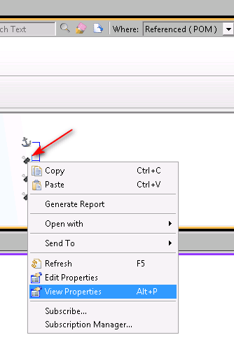

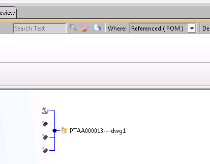

Once created, select the UGPart. it will show the relations in the Impact analysis.
Right-clik on the "clips" and select view properties.
Do this for each clip until you find the one showing the UGPart as Primary reference and the UGMaster as Secondary.
It should show you the relations as shown below.
