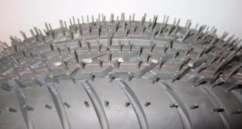

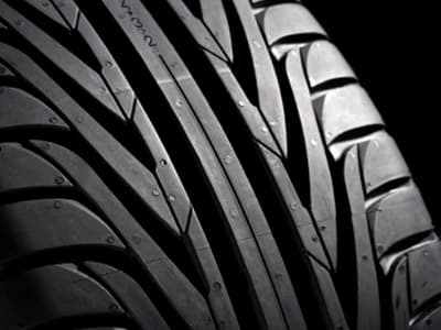

There are also vents on the outside performing the same purpose - you know, those little strands of rubber. I've seen the word "spew" to describe these, but no one I know within the tire industry uses that term. Usually they are trimmed off - or they have a mushroom shaped valve that closes, but leaves a small round impression. Go look at the outside of the tires on your car to see these.
Here's a photo of those vents:
Here's one showing the other kind - the mushroom shaped. Note the circles:
