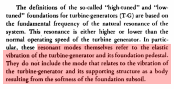

Buoyancy will make the weight lighter... but mass, not weight, is important for a tuned foundation. Mass is not affected by buoyancy. Damping of vibration by soil may be affected by high water table, but that does not affect foundation tuning, either.
Our generating stations (in high water table locations) use high-tuned turbine-generator pedestals where the structure dedicated for tuning (piling, foundation, pedestal, and the machine) is considered part of the tuned mass.

1) Not necessarily. The structure, including the machine, has to be designed to vibrate exactly opposite (both frequency and magnitude) to the machine-caused vibration. Then the two sets of vibrations cancel out each other. The soil/piling spring constant has nothing to do with this.
2) No, as stated in 1), neither soil nor water table have anything to do with a tuned foundation.
There are other ways to design foundations for vibrating machines. Believe I misunderstood your question... I thought it was about tuned foundations. Sorry.
