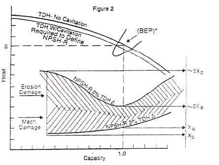

Because "cavitation" is difficult to accurately define or measure the onset, whereas 3% drop is relatively straightforward and easy. Any air ingress into the water inlet tends to mask the typical noise heard.
Often the onset of cavitation is higher than the NPSHr curve hence the normal requirement to be min 1m above, however if you operate at lower or higher points on the curve than BEP, this margin can vary - see graph below.

NPSHR has +0% tolerance in every spec and standard that I am aware of. It must be a conservative number so that every time that pump is manufactured, NPSHR is less than or equal to the value that was quoted.
So, if NPSHA<NPSHR, a pump with perfect castings might not cavitate, at least not as measured by a 3% head drop. Small pumps are more sensitive to little variations in the castings (surface condition, vane thickness) so the difference between a "good impeller" and a "not so good impeller" has more of an effect on NPSHR than with larger pumps.
