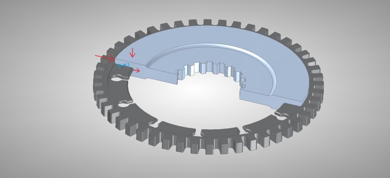

We have a die cast aluminium rotor that we would like to incorporate a steel rim into to act as a target for a hall effect speed sensor (making the entire rotor from steel is not a good option).

It doesn't have to be a rim but it will be 48/64 tooth so individual pieces will be impracticable and give bad tolerances. I had considered a rim with internal teeth which would be overmolded, the outer rim would then be machined away leaving the teeth inside, but I still have to figure out how to deal with the aluminium shrinkage.
How would the aluminium shrink in a design like this? Would it shrink away from the web or onto it? For reference this model is 48T, OD = 77mm, Thickness = 6mm max
It all depends on how/whether the alum. solidifies in the keyslots before the rest of it solidifies, and if radial stresses high enough to create voiding/tears develop as it solidifies and shrinks.

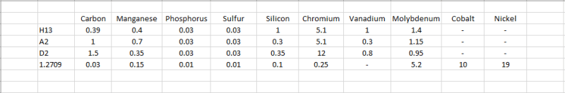

Going off topic so if you think this warrants it's own thread in the magnetic forum let me know. For the rim we are considering 3D metal printing but none of the suppliers can provide magnetic properties for their materials. As it is just the prototype I am not concerned with the exact properties but would at least like to confirm it will have reasonable permeability, what do you think would be the best bet between maraging steel (1.2709), H13, A2, D2 tool steel(ASTM)?

Tools steels make good permanent magnets, they are not magnetically soft materials.
Why not a plain low C steel?
7,000 - 10,000 rpm. The only reason for choosing high strength steels is they are the only options I can get from 3D printing suppliers, I guess there isn't much of a market for spending £000's to manufacture cheap low strength steel.
We plan to sinter the production version in a low carbon steel which we know has the magnetic properties we are after. But before we launch tooling we need to prove the concept, hence the 3D printed prototype.
The prototype has two main goals: to prove the sensor design works & to trial the overmolding concept. The sensor is a back-biased differential type so is detecting the change in magnetic field caused by the influence of the toothed gear, so although not ideal I think a magnetically hard material should still work, maybe?
