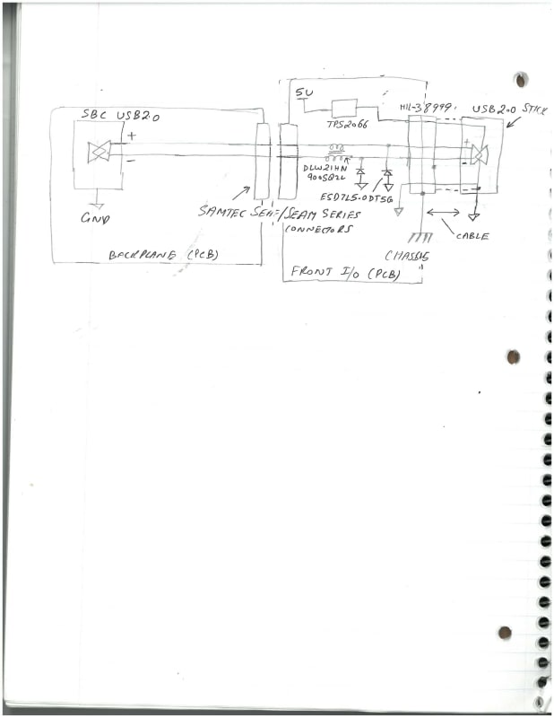

We are working with a USB2.0 design that has attached circuit block diagram. The USB2.0 is working intermittently. USB 1.0 works fine. We have ruled out a few things now. We are doing eye pattern under various scenarios and trying to see what is causing the issue. We are reading eye pattern on USB 2.0 drive connector pins. Our observations are following so far.
1. Choke DLW in schematic has no negative impact on eye pattern. We shorted the choke with no change to the signal.
2. Diode ESD has no negative impact on eye pattern. We removed the diode with not change to the signal.
3. There is no noticeable negative attenuation from SEAF/SEAM connectors or at MIL-DTL-38999 connectors.
4. The PCB routing is fairly straight forward with correct impedance of 90 ohms.
5. USB voltage is 4.9V and is within specification.
6. Rise and fall and voltage are within USB specification.
What we know so far is that if shell of MIL-38999 connector is connected to chassis plane on the Front IO PCB we get a bad eye pattern. If this connection is left floating then we get good eye pattern. The scope shots of signals and eye pattern are attached with shell connected to chassis plane and shell not connected to chassis plane. Interesting thing is if the chassis plane is left unconnected to chassis we still get same behavior and signal comes out bad. We are not connecting Chassis to Digital GND in our design but USB2.0 stick connects shell to the Digital GND that connects chassis to Digital GND when mated with cable.
The USB 2.0 Signal is generated by putting USB2.0 host in test mode using USB.org provided test software called USBHSETT. This tool takes over the USB 2.0 driver and put the host in test mode where it can send packets so that eye pattern can be obtained. The scope is 24GHz Tektronix scope.
Any thoughts on the issue will be much appreciated.

If you haven't already, check for voltage differences between the various 'grounds' and check for resultant currents.
Then think about shielding, and keeping induced common mode current off your signal lines.
Grounding in certain electrical designs is not for the faint of heart; some grounds are not true grounds. Note that differential circuits are never ideal, since the circuits that implement the functions have limitations on common-mode voltage, and floating grounds are often recipes for disaster.

You guys are certainly correct on the point that this a grounding issue. But let me first answer the questions.
How long is the cable (shown on the right side)?
(K) The cable is 6 feet long.
Are there other power or signal wires contained in the same cable?
(K) Yes, there are signals and power. I have updated the circuit drawing to show power wires that are affecting the USB 2.0 working.More on it in the end.

(K) I agree with your statement. This seems like a big simple problem. Our system is 28V system. It takes in 28V as main input power. I noticed noise on USB2.0 diff pair + side with reference to digital GND and same thing on diff pair - side with reference to Digital GND. But cannot put finger where this is originating.
Since yesterday we did some more testing and have some more findings.
Refer to the updated circuit below in that regard. P1a and P1b are sub parts of same connector. J1a and J1b are sub parts of same connector.
What we are noticing is if we disconnect the shield of 28V and 28V RTN twisted pair wire from the 38999 connector shell side the USB2.0 works and reconnecting it makes it intermittent again and it is repeatable. The 9 pin DSUB does not have any other signals on it and it is not powering anything. So the 28V power wire shield is contributing to the issue it seems. I am finding this behavior little weird at this point. Hopefully you guys have some insight into it.
Thanks again.
It is a technique * to ground the shields at only one end, assuming that you have dedicated power and signal return lines, as well as a wire to interconnect the two local grounds. Shields aren't supposed to carry (ground) currents between two boxes.
* I'm not sure how widely 'accepted' it is; as ideally the shields are 360° grounded at each end.
You should probably track down where the ground currents are arising, and confirm the theory at the same time. Use the frequency domain to provide clues (e.g. 60 Hz?). Turn things off, provide local battery power instead of supplying power, eliminate things one by one.
Also, beware in case it's just a bad part.

> How is the ±28V being generated, and what is the 28VRTN coming from?
> Chassis connections in the old days used to be tied to neutral, which isn't actually a ground
> I would go with VEIBLL's suggestion and measure the current between the 28V shield and your shield
> Note that shields that aren't properly grounded have a nasty habit of getting AC-coupled to line, often resulting in excessive voltage and ground currents that can cause noise problems
> Note that chassis ground IS NOT, and CANNOT, be circuit ground; any return currents running around in your chassis system is another noise source

Hopefully you've debugged this by now. If not...
It looks like 28V RTN (or 28V) is inadvertently getting connected to the shield around the DB9 circuitry. This could be passing the 'chassis ground' noise onto your other return/ground nets and causing havoc. This could be as simple as a single strand from a poorly crimped wire touching the DB9 case.
