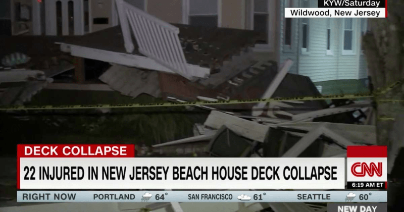

It looked pretty reasonable, before. Interestingly, the roof overhang stayed intact.
TTFN (ta ta for now)

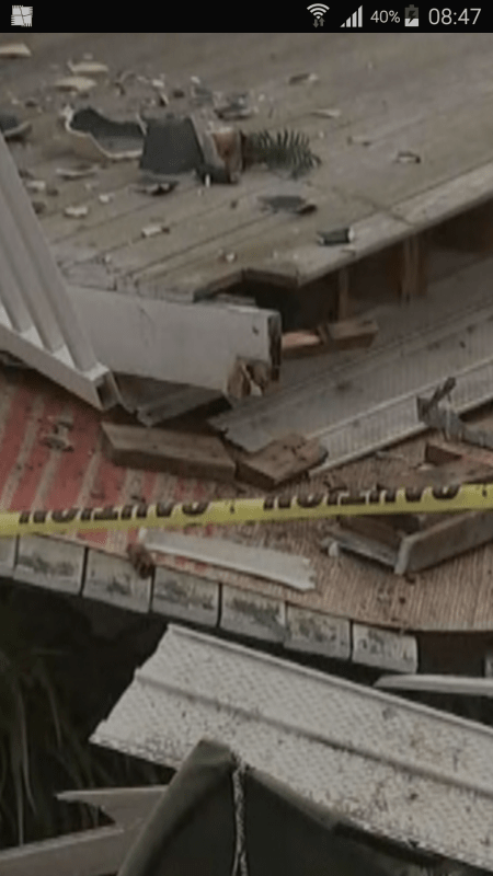

This picture shows the deck survived as a complete slab.

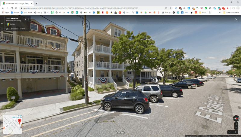

Looking closely it looks like the main beams run parallel to the building with only the odd bit of 10x2 actually holding it up!!
Looks like quite a heavy deck to start with.
Re: Image posted by LittleInch - The joists and ledger do not look healthy, nevermind the logic in the structural layout. The deck slats also allow for generous water penetration of the hidden structure. Obvious external decay does not bode well for that which could not be seen.

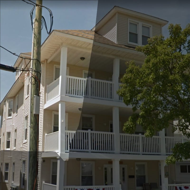

Re: Image posted by IRstuff - An initial glance can be dismissive of the misaligned columns given stitching of multiple images by Google Earth, however closer inspection reveals either significant maintenance issues, poor construction techniques, or both.
EDIT: It seems I missed a seam across the middle of the highlight, but I will otherwise leave the post as is. From multiple angles, something is not right with that deck.

This appears to be a drip through deck (there is no membrane and water can drip through the deck) with a soffit. This is not great since the rain water goes through the deck but the soffit help retain the water. One thing this deck had going for it was the roof over which would have minimized the exposure to rain. Good practice is to avoid drip through decks that are supporting a portion of the building such as this case. Although the roof protects the deck, it is not a great idea to rely on the drip through deck to support the roof. I am also not a fan of multilevel drip through decks.
From the photos on google, it looks like the joist were running parallel to the facade which is unusual. I couldn't see any connections for the beams into the building. There should be beams at the column locations.
One report said that this was a pancake type failure. Another witness said the first level came down first and the other level came down slowly. This contradicts the claim that this was a pancake failure.
There doesn't appear to be much damage to the facade of the building. Glass and siding are not broken or ripped away from the face. However, the connection to the building does not appear to be substantial. The other possibility is that the one witness was correct. The fist suspended level failed first, the columns were pushed outward and then the upper level was pulled out.
Looks like nothing more than a 2x10 nailer onto the lower wall header or floor joist.
A relatively new construction, no?
A 2x10 ledger is a common detail. The direction of the joist are usually perpendicular to the ledger. Otherwise, the ledger has to support point loads from the beams.
