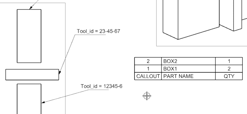

Have you tried using the parts list ?
set the "balloon" to present the Tool_id instead of the callout.
I imagine that Tool_id is an attribute that your company sets on all components. ( ? )
I have attached an example, NX10, where the callout is "underline" instead of the regular balloon. ( The tool_id does not fit inside a balloon)
If you add "balloon" and select the type to be "underline" ( do not type anything) , place the leader on the edge of the lower box that's missing a note , then update the partslist, it will / should update that new underline-balloon.
I have set the callout for this partslist to "Tool_id = <W$=@tool_id>"

1, i do not know a way to avoid this, i assume that it's a European customer who has required the underline- balloon type.
Try the other balloon types such as "Rounded Box" and see if any other balloon shape works for you . ( for the rounded box , set the size to maybe 2" or 25 mm ?)
2, my example adds "Tool Id=" because the callout for the balloon is set to "Tool_id = <W$=@tool_id>" ... ;-)
RMB the partslist, -settings - see the image below
3, these balloons are 100% dependent on the partslist and will disappear if the partslist goes.
Move the partslist to an invisible layer .( or hide it)
It is oddly a little more difficult to move it to a different sheet ( and keep auto-balloons) but i think manual balloons does stay.
-one has to fiddle with view dependent edit to move the parts list and keep the balloons.

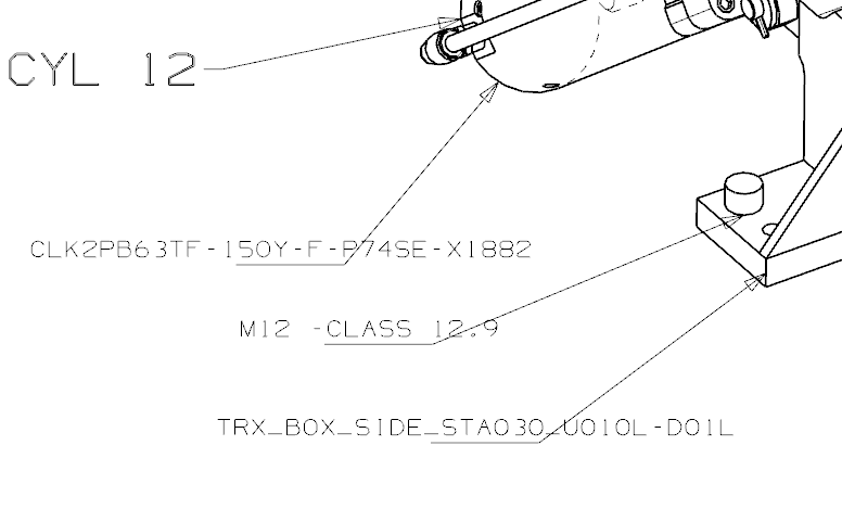

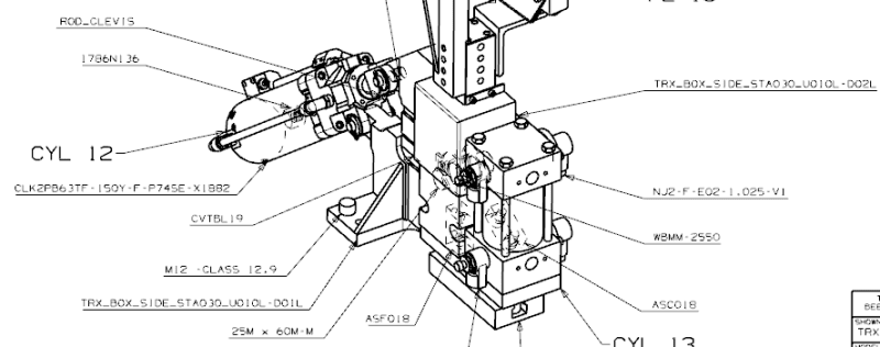

This what I am coming up with so far. The CYL-12 note is just a regular note. That is how we like our leaders if possible. If we can at least make them look decent we could change up but I know they wont buy into these leaders.
Whatever the outcome, I want to say thanks for the help. There is a guy my company has been paying to create certain programs for us. A hole chart, a stocklist program etc... I have a feeling this will just come down to the company paying him to create this as well. lol
So in playing with it some, I learned that once the labels are in position, if you double click a single label, you dont have to click on anything else and can just type a number in and hit enter and the length of the underline will adjust. In ours the starting length is set at 14. So depending on how long the label is I can quickly get used to about how long to make it. If I adjust it and it still needs more length, I dont need to do anything but type another number and hit enter. Keep doing that until the underline looks good.
Seems like a lot of work in explaining it, but even if you have 50 labels, once you get used to it, it wont take long. Its better than having to create each note one by one.
The end result isnt too bad. I might be able to get the bosses to buy into it. At least temporarily until they get a program written up for it.
