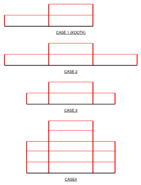

Caveat: I violated what you said and didn't quite fully digest the sketch, but I'm going to respond anyway!
Assuming flexible diaphragms, I have done separate analyses line by line many times over.
I typically trigger it when I see large discrepancies in mass distribution, or like your case, story discrepancies.
I've also done this in a "single story" steel building with an interior mezzanine along one side of the building. 2 story analysis for the side w/ mezz, 1 story for the other side. I am confident that I have read this as an example in a design guide somewhere, but I can't recall where...

Certainly, more extreme situations nag at my gut feel for the situation more than others. A 50'x50' L2 over a 50'x65' L1 gives me no grief. For the actual building that I'm working on, which is close in proportion to your case 1, my visceral response to the thing is that little of the Cs response should be getting "siphoned" away to the multi-story part of the building. That, particularly, given that my low roof has gravel & pavers making that area a more mass intensive than the rest.
It's a weird thing though. I'm highly analytical by nature. Once I put myself in the zone with respect to "flexible diaphragm" it's hard for me to turn it off and remain objective.
Deker said:
What about for the configurations shown below?
All four for me. Case four is particularly bothersome. With the two stories, I'm confident that all of the walls will have very short periods and that the risk of inducing meaningfully different vibratory responses among the walls is small. As it gets taller, I start to worry more about individual walls doing their own seismic dance as it were. The higher up in the air a diaphragm is, the more I like it to be rigid.
