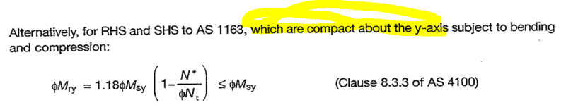

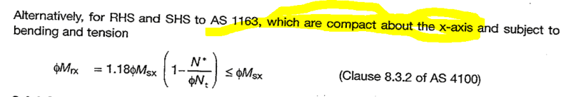

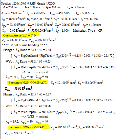

What are peoples thoughts on this situation:-
Both AS & NZ steel standards allow the use of alternative design provisions for combined actions, i.e. if section is compact, is a doubly symmetric I section or a square hollow section alternative equations can be used in chapter 8. NZ code has some further qualifying provisions for applying these alternative provisions on top of the smaller subset of requirements in AS4100. These relate to alternative slenderness requirements and axial load limits but are not important with regard to the intent of this query.
I was wondering what peoples interpretation of 'compactness' is in terms of application of these provisions, say we have the situation whereby a rectangular hollow section is compact about major axis but non-compact or even slender about the minor axis.
1. If section is subject to only major axis bending then you'd only need to be compact about this axis to use the alternative provisions, so our example RHS would satisfy this requirement?
2. If section is subject to only minor axis bending then I'd say you cannot use the alternative design provisions as you are not compact about this axis. This aspect seems clear to me as the intent of the standards.

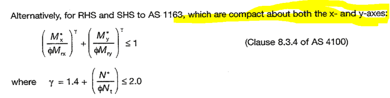

3. If section is subject to biaxial bending then you'd need to be compact about both axes to use the alternative provisions.
4. Or would you only apply the alternative design provisions if the section was compact about both axes even if there was only uniaxial bending?
Keep in mind the alternative provisions are a means of allowing for more capacity due to allowing some yielding and inelastic action within the cross section provided it doesn't impact on member stability and the like. So it makes sense to me at least that you should only need to consider the compactness about the axis of loading to achieve this increase as element slenderness is satisfied about that axis?
Any agreement/disagreement/comments with this approach?
I have not been able to find anything which states definitely one way or the other if a single axis of being compact is ok vs requiring both to correctly apply these provisions.

Interestingly when I started out down the path of writing all the checks into some python code I was under the impression that AS4100 and NZS3404 approaches were going to be more or less the same except for the addition of some earthquake stuff in NZ code. But the more I get into it there seems to be a lot of differences in the stuff I'd always thought was the same. Don't get me wrong, 95% is word for word the same, but obviously with the seismic thing in NZ there warranted some differences obviously, and there are a few other things that have feed into our standard over time base don research that has meant they have diverged slightly in some aspects. The code I am producing (which I will open source when complete) I was hoping would be able to do both standards with little effort, but this would require quite a bit more work to separate it into NZ and AS stuff now that I'm into it.
I've found that the AISC Design Capacity Tables for Open Sections ....
Thanks for that, I'll take a look at the closed sections and open sections versions and see if its definitive.
I think looking through the ASI tables, and the examples given there it's pretty definitive that to apply alternative provisions you need to be compact about the axis of bending. Or for biaxial alternative provisions compact about both axes. For biaxial if you only have compact section about one axes, then you use the normal biaxial check, but you can still use the alternative ΦMry or ΦMrx provision about that one axis (the nomenclature is slightly different between AS and NZ standards, but the intent is the same). In the normal provision you don't have the 1.4+ power, its just a linear relationship, but you are still taking advantage of the increase in capacity about that one axis by being able to use the alternative capacity which answers your point below I guess:-
In a similar vein, there must be some threshold below which the minor axis moment on the X-compact/Y-slender RHS has negligible effect and the alternative provision capacity is still valid. Does M*y = 1% of phi.Msy (~3 MPa) mean we have to give away the 18% capacity increase? This probably exists in real structures due to tolerances and compatibility rotations but we ignore it.
Thanks for the lead on that, confirms my original thinking.

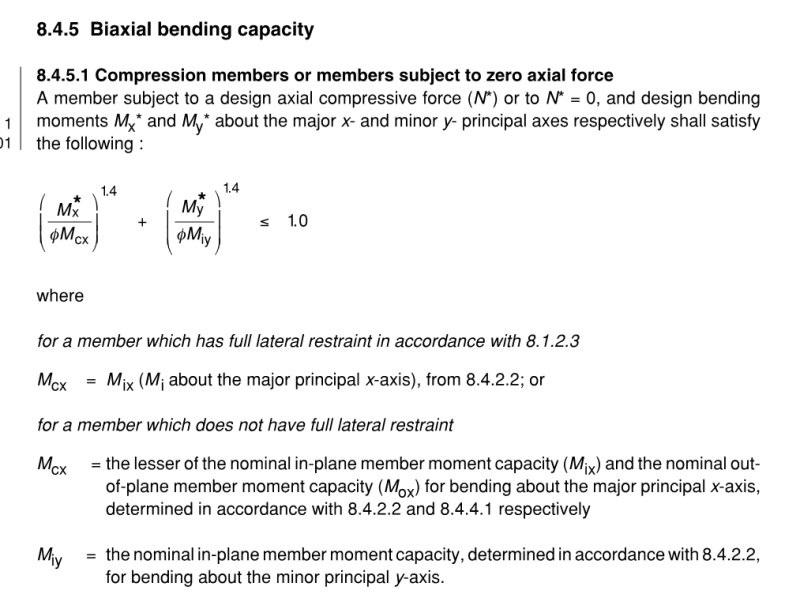

The normal biaxial section check in 8.3.4.1 reverts to section capacity Msx instead of Mrx. So N*=20% of capacity plus M*x=94% is ok using uniaxial alt provision. Add 1% of M*y (Y-slender) and it becomes available 15% over?
Agree for section check. , I was more referring to the member biaxial check specifically, because this is where its different and you can use Mrx (this clause basically from NZS3404), Mrx cannot be greater than Msx for obvious reasons:-
Mox here is basically Mrx from AS code (evaluated to alternative provisions if you satisfy all of the requirements of 8.1.5), this is where the nomenclature and subscripts changes between codes, but like I noted the intent is the same I believe.

After all 8.3.1 & specifically 8.3.1(c) says for biaxial bending all you need to satisfy is the biaxial check, you work out the other values along the way though, so in case of not meeting alternative provisions about 1 axis then for section check you use the non alternative provision. Similar applies in reading 8.4.1 & specifically 8.4.1(c) regarding member check.
For section check, every station along a member needs to satisfy the inequality, but for member check its one check for the entire member based on maximum loads. Maximum loads don't need to coincide with respect to location, it's more about combined effect of member buckling and/or remaining stable.

The alternative provisions aren't linear but the lower tier pretty much is. I've concocted this example:
250x150x8 RHS gr.450
N*=480 kN (20%)
M*x = 183 kNm (94%)
Alternative provision section check passes.
Now add M*y = 1 kNm. Can no longer use alternative provision section check as slender for M*y. Increase to 9mm wall thickness but still fail lower tier check so need 10mm wall (23% weight increase). Or do you use judgment to ignore M*y? If so, what is the threshold?
I'm also hung up on reducing capacity for slenderness when the entire section is in (varying) tension. Is this a real phenomenon?

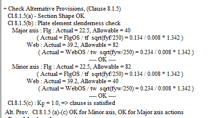

Looking at your example in MEMDES which is a common program for checking steel in NZ, it notes in checking to section 5 limits the 250x150x8 G450 section is non-compact about both axes (web critical). 250x150x9 & 250x150x10 are also non-compact about both axes. Though I'm not convinced they actually have it correct as they get some funny numbers to be honest when checking to section 5 (need to look into it further). Checking the 8.1.5(c)(ii) requirements are satisfied though, even for the 250x150x8 section about both axes, this allows the use of alternative provisions about both axes. When you drop to 6mm wall thickness you start to get one axis satisfying the 8.1.5(c)(ii) check and the other not satisfying (need to digest what path they take beyond this point for the combined actions checks).
Note that we have slightly different slenderness values for hollow sections and webs of I-sections which may help explain the differences if you are using some software to come up with your comparison when assessing compactness to section 5.
The problem is MEMDES doesn't check all requirements for some of the checks required, sometimes it warns you about certain things, other times there is no warning (if you read the manual it highlights some of the things it assumes/does not check). This was part of the impetus for coding up the checks in python, as some of the things really need to be checked and people weren't/don't do it in practice.
Million dollar question I guess, totally see where you are coming from, but going back to first principles, if you get local plate buckling about the y direction then it's all over as far as the code is concerned. The buckling completely destabilises the entire plate element. Codes are fairly binary, they need to be I guess.
If a plate element is in tension (like tension flange in I-Section) then it cannot buckle/not subject to local buckling. Combined actions section checks with section in tension always use ΦMsx, this by its nature includes the slenderness reductions obviously (which I agree could be counterintuitive with large tension and small bending resulting in full cross section being in tension). I guess this is simply a by product of one design rule to cover all situations, simplicity and conservatism wins over evaluating things 15 different ways for small benefit.
The AusTube Mills tables say that 250x150x8/9/10 are all X-compact/Y-noncompact. I just took their word for it and did calcs on the back of an envelope. And yes, I did cherry pick the only case where 1% of M*y requires two steps up in wall thickness.
Yeah that's the thing, in MEMDES it initially lists it as X-compact/Y-noncompact which is why I was saying the numbers were a bit screwy (see output below), but then when it actually checks it they come up with non compact about both axes. I suspect I've found an error in the program though, looking at the red underlined value it should actually be 45 as per table 5.2 of NZS3404 for 'web' x axis bending (i.e. case 4 from table 5.2). If 45 is used then its compact.

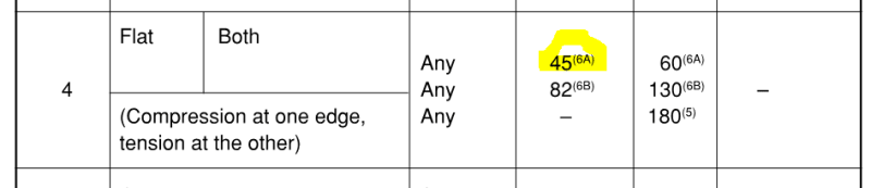

Note in AS4100 the limit is 82/115 for case 4, but in NZ for webs of hollow sections its 45/60. I remember at the time they amended this they mentioned it was due to seismic concerns, cyclic loading causing local buckling at a ratio of 82 based on experiments/research, etc. So limits were tightened up considerably, previously they were 82/130 pre-amendment for both hollow and I-sections (so different from AS standard of 82/115).
I remember years ago AustTube Mills (used to be Smorgon Steel from memory) used to have separate NZ and Aust property tables for the reason of the different slenderness ratios for the webs. I've never seen these hollow sections in NZ though. I guess you can indent them, but unless you need hundreds of meters of section it's not even a practical option to use them.
Note that for use of alternative provisions using table 8.1 that the limit is still 82 for the web, therefore the 250x150x8 section with a ratio of 39.2 would still be classified as "compact" using 8.1.5(b)(ii) for application of applying combined actions checks with the alternative provisions. Pretty confusing!
