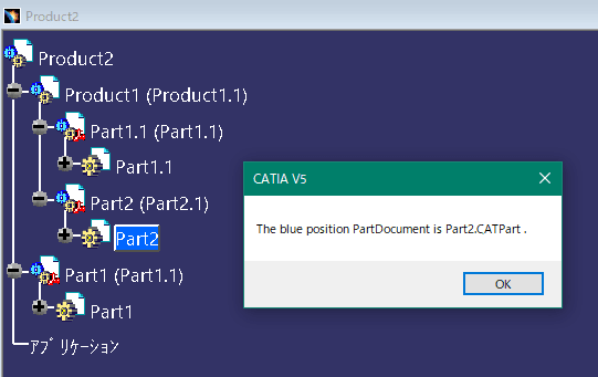

I want my macro to create geometry in the active catpart that's inside a product. I don't want to have to open the catpart in a separate window.
I was thinking the below but I'm drawing a blank here...
Dim Documents1 As Documents
Set Documents1 = CATIA.Documents
Dim PartDocument1 As PartDocument
Set PartDocument1 = Documents1.Item("")
Dim Part1 As Part
Set Part1 = PartDocument1.Part
Isn't it the ”blue problem“ written here?
Link
I thought about the code to get the partDocument of the blue position by using plane search.
Code:
Sub CATMain()
    Dim doc As PartDocument
    Set doc = GetBluePosionPartDoc()
    Dim msg As String
    If doc Is Nothing Then
        msg = "There is no blue position PartDocument."
    Else
        msg = "The blue position PartDocument is " & doc.Name & " ."
    End If
    MsgBox msg
End Sub
Private Function GetBluePosionPartDoc() As PartDocument
    Set GetBluePosionPartDoc = Nothing
    Dim sel As selection
    Set sel = CATIA.ActiveDocument.selection
    CATIA.HSOSynchronized = False
    With sel
        .Clear
        .Search "CATPrtSearch.Plane,in"
        If .Count2 < 1 Then GoTo fin
        Set GetBluePosionPartDoc = .Item2(1).Value.Parent.Parent
        .Clear
    End With
fin:
    CATIA.HSOSynchronized = True
End Function
