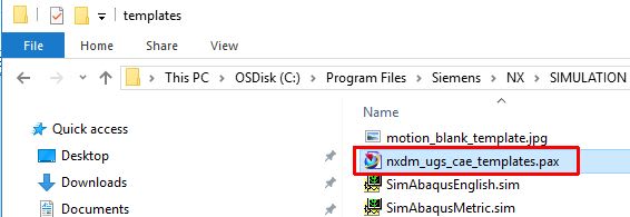

Whomever told you TC doesn't support Simulation is wrong.
We have customers who use NX, Simcenter & Teamcenter.
Simple to prove this, if you look in the SIMULATION\templates folder where your NX is installed, you'll find a nxdm_ugs_cae_templates.pax file.
This palette file controls the simulation templates available for NX and is trying to call the parts from TC.

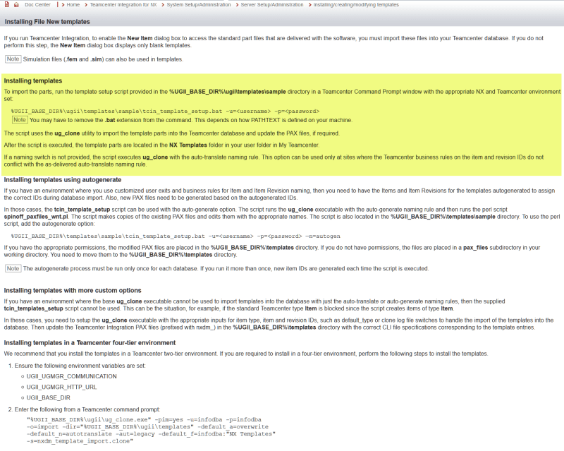

As you don't have them imported, you need to do the following for the templates that exist in that templates folder.
Image below is cut from the NX docs, link is here:

FYI, once the pax files are installed/loaded into Teamcenter, you'll need to be sure to update the Teamcenter preference that tells NX where to look for the templates. For NX 12 that preference is TC_NX_FileNewPaxFiles_NX12. If you aren't running NX 12 replace 12 with the version you are on.
