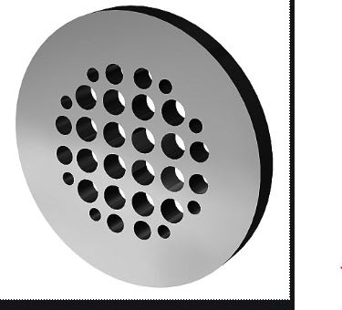

Try looking up ISO 5167 or google "ISO flow straightener" of flow conditioner
I've installed insert flanges like this on the pump inlet flange.
If it's good enepough for a metering system its good enough for pumps.
You also see sometime guided vane elbows.
https://empoweringpumps.com/metraflex-suction-diff...

Thank you for the suggestions. Your suggestions have led to the following information/insights as this subject pertains to pump inlet conditions:
Non-uniform flow may exhibit:
- swirl
- assymmetry
- etc.
non-uniformity of the velocity exiting the elbow can cause local acceleration at the impeller vanes, resulting in low-pressure areas and cavitation.” Suction Diffuser Vanes for Pump Applications (August 29, 2017, Empowering Pumps & Equipment), (https://empoweringpumps.com/metraflex-suction-diff...)
Poorly developed flow may result in:
- Cavitation
- excessive vibration
- poor pump performance
- bearing failure
- seal failure
- Impeller failure
- Impeller imbalance
- noise
- high maintenance costs
- high power consumption
- Increased head
- Decreased flow
Information from the flow metering industry:
- Recommended straight pipe diameters for flow measurement: 25 to 40 x D (upstream) (or as high as 95D); 4 to 5 x D (downstream) (or as high as 7D)
- Other piping standards are closer to 5xD upstream (or less)
- LxD may be shortened via use of flow conditioners
- often insufficient physical space to achieve recommended LxD
Types of flow conditioners:
- folded vane
- twisted vane (imparts rotation on flow)
- tube
- Zanker
- fin
- disturbance plate (Sprenkle)
- Vortab (swirl reduction via generation of small counter vortices)
- devices should only be installed in extreme cases after all options have been considered
One might consider quantifying the inferred effects of flow conditioners via before and after vibration monitoring.
