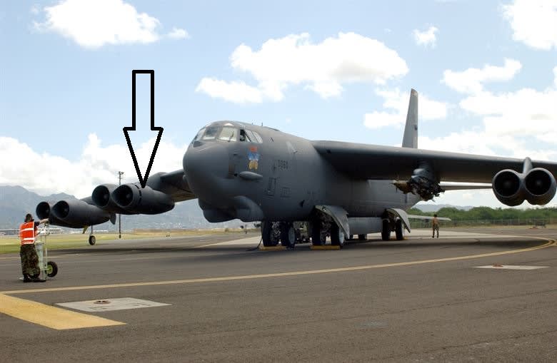

Comcokid is correct, but I determined it was a G model in a slightly different way. The tail profile (first OP photo) is the shortened version, which only existed on the G and H models. The A through F models had a taller tail which more closely approached an apex point. The G and H model tails always stand out to me by their profile.
Second, once it was down to a G or an H, then I looked at the engines. The OP photo aircraft has the older J-57 turbojet engines (see again first OP photo), but the H had the newer TF-33 turbofans with the oversize inlet cowls (see my photo of an H below). The TF-33 engine on the H is why the H models at takeoff power never created exhaust clouds of such starkly monstrous size and dark coloration as the J-57 engines did with water injection.
