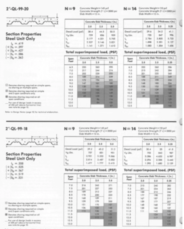

We are working on a 1973 project that has Robertson QL99-20 deck on first and second floor. It is 3" deep with a 4" hard rock concrete with wire mesh. I am looking for load tables (gravity and shear values). I would very much appreciate if anyone has information on this that we could use. Thank you

It opened for me but the QL-99-20 deck listed is 2" in depth and not very easy to read:

msquared48 had a more legible copy of 3"-QL-99-18 but not 20 ga. Perhaps he is able to provide that.
