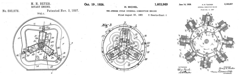

Granted. The same could be said for an engine using crankshafts and pistons yet there are thousands of patents issued for such engines. I spent months performing patent searches before committing to spending the money required to file a patent through an attorney. I wouldn't have filed had I seen even one cam-driven opposed-piston cam-engine. The earliest relevant patent I found was the Beyer Engine of 1897. That patent alone would invalidate all cam-driven engines claiming nothing more than replacement of a crankshaft with a cam. The patent that comes the closest to mine is the Michel engine of 1921 which shows three pistons working a shared chamber. I also found the Tucker Engine of 1937 which is, in my opinion, the same engine as Ardezonne's but for the fact the space between cylinders is open for air cooling rather than enclosed for liquid cooling. I found no engines using two cams controlling opposed pistons in a radial engine much less any with a third charging piston or any using the combination of small pistons, radial cylinders, and cam timing to overcome the challenges of HCCI.
I was very reluctant to proceed with a patent because, frankly, I felt any engine worth considering has likely been tried and, with very few exceptions (eg. Wankel), tossed into the dustbin of failed engines that were going to change the world. Cam engines in particular have proven to be inefficient. Michel actually took his to production but abandoned it over time because crank engines were superior. All of this history with cam engines and rotating cylinder radial cam engines in particular occurred before the benefits of HCCI were well understood, however. I held off on filing until my math models were complete, and they showed that HCCI had the potential to increase efficiency sufficiently to overcome the inefficiencies of such engines. HCCI is difficult to tame, however, which is why nobody has yet produced one that uses HCCI exclusively. Using cams to control opposed pistons in a radial configuration promises to overcome the challenges of full-time HCCI through precise control of timing and minimization of cylinder to cylinder variance in temperature due to the lack of "end cylinders." My engine design consultant agreed. As it turns out, HCCI also makes rotating cylinder radials less complex because it eliminates the need for spark plugs rotating with the cylinder. Using a two-stroke opposed piston approach also eliminates the need for a valve train, further simplifying the otherwise highly complex rotating cylinder radial.
