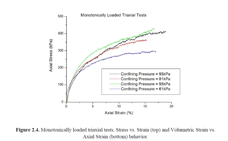

I need Drucker-Prager hardening how i can define it from result of Triaxial test

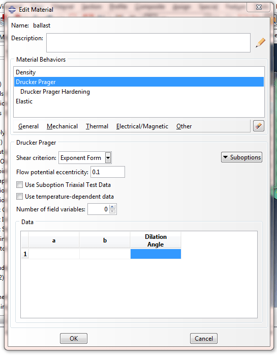

I use hyperbolic drucker-prager and input Internal Angle of Friction and Angle of Dilation
but my analyses is aborted with an error that say *drucker prager requires the use of *drucker prager hardening.
how can fix it.

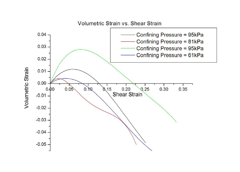

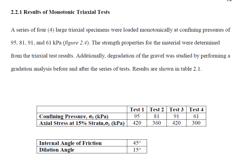

in article say the ballast shear strength properties were obtained from this article is attached.
In this window that you show here there's a button called Suboptions. Click it and you will be able to choose Drucker Prager Hardening. There you can specify the data I mentioned in previous post. It will eliminate the error. Also if you select the box named "Use Suboption Triaxial Test Data" you will be able to specify the data obtained from triaxial test. But this is for exponential form.
I'm sorry I cant understand this. Can I only use Triaxil test result to define? and Due to the result I mentioned in previous post
What numbers should I enter in the form below?
Yes, you can use this triaxial data suboption to define Drucker-Prager model (but you will have to switch to exponential type). In those two fields put σ_1 = σ_2 and σ_3 values respectively (include signs too). Parameters a, b and pt are optional, you don’t have to put them. If you add hardening too then pt will be taken from hardening data and this field here (in triaxial data suboption window) will be ignored.
When you use exponent form of Drucker Prager model together with triaxial test data then you only have to specify the dilation angle. Remaining two parameters (a and b) can be omitted.

I want to define ballast properties in abaqus with durcker-Prager hyperbolic shear criterion . I had internal angle of friction and dilation but I cant Understand correctly how can i define hardening .as I mentioned in previous post i have the result triaxial comperetion test. know What amounts i must enter in rows of hardening stress and strain.
