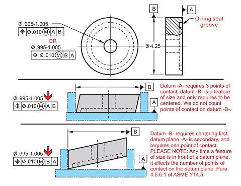

Not sure what datum callouts are needed. I have a thin circular disc with a radially symmetric, triangular pitch hole pattern.
I think if I add another 0.292 basic or the 60° basic to the pattern, and change the vertical and horizontal lines through the part to actual centerlines, the holes are then dimensionally specified. Otherwise, the central hole could be established as Datum B and the remaining hole positions could be relative to A | B. I may impose a material condition on the feature, but it will not be on the datum(s).
I would appreciate guidance on this.
Your brother in engineering
Lonnie

Appreciate the comments. This is a baffle for a tube and shell heat exchanger. Tubes will run through the holes.
I think the diameter should be the primary datum. I believe the parts fit and function is better fulfilled in the bottom of the image in this thread. I think the face is not an important feature.

The largest flat face should be the primary datum unless you do not care if it goes in the next assembly at up to a 15 degree angle to the tubes.
It is not shown (indeed there is only an associated reference dimension?) but the thickness or each individual flat face could be controlled relative to the OD.
That being said, I think the practicalities of measuring/inspecting the UAME of the OD of such a large, thin disk would make a case for making the flat face(s) the primary datum feature as suggested.

In the context provided by the OP and the picture from one of his replies, may I ask if datum feature A used as secondary in the FCF for position of the central hole provide anything to this location control?
(If assuming also no simultaneous requirement concept is to be used, but strictly as a stand-alone position control). What does Datum feature A secondary do?

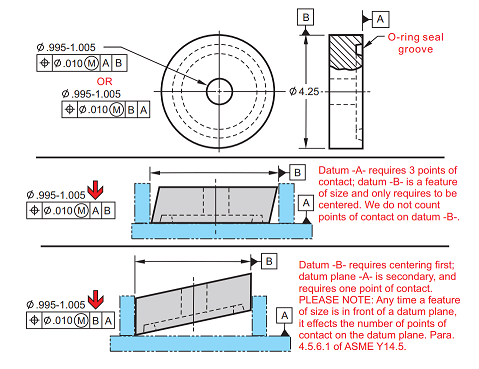

With respect to the face or diameter being the primary datum, it is more important for fit that the part fits within a cylinder with the hole pattern centered on the part. I guess since the part is so thin, the exaggerated shear of the top with the plane as primary and the diameter of secondary is still valid.
L Fultz,
When referenced as primary datum feature, a cylindrical surface must constrain one rotational and two translational degrees of freedom. Your datum feature A will be unable to provide any practical constraint of rotation because the length/diameter ratio is much too small. This is a problem regardless of which feature seems most functionally relevant to you.
Do you actually want to allow parts that can only be assembled with the sheet thickness at some huge angle away from perpendicular with the tubes? I can't imagine why you would, but there are better ways to do it if you insist.
