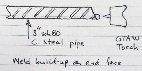

The sketch below shows the configuration that is giving us porosity problems. All the usual suspects have been investigated and ruled out. GTAW welding is done orbitally, using argon shield gas.
I suspect the problem results from the absence of a shielding gas 'backstop' that the base metal provides in typical welding configurations.
I would appreciate any suggestions for cup size, gas lenses, tungsten stick-out, or some kind of barrier that could help contain the argon and prevent air entrainment.

Have you tried putting a soft seal plug into the pipe just beyond the hottest area?
That might trap enough Ar, or at least prevent the 'chimney effect' and give you chance at a better weld.

Porosity coming from lack of gas shielding or from impurities?
If the former, a weed burner with steel gauze (to make it a giant gas lense) fed by an argon bottle might help...

I can't help but think the high density of Argon (combined with the geometry) is the culprit.

I would tack weld a metal backing strip to the I.D. and extend it some distance beyond the root face then make your weld against the backing strip and root face. When complete, grind off backing strip to conform with I.D. requirements. If some areas are shallow hand weld to conformity.

That is in fact now being done, and they are having better success.

I think EdStainless's original post may be the way to go - remove the "chimney" effect.
What about a round ID insert plate just inside the end of pipe held by a couple of small tack welds ?

It now looks like the problem is contamination of the shielding gas upstream.

To be precise, moisture was forming or entering the regulator, which has since been upgraded.
