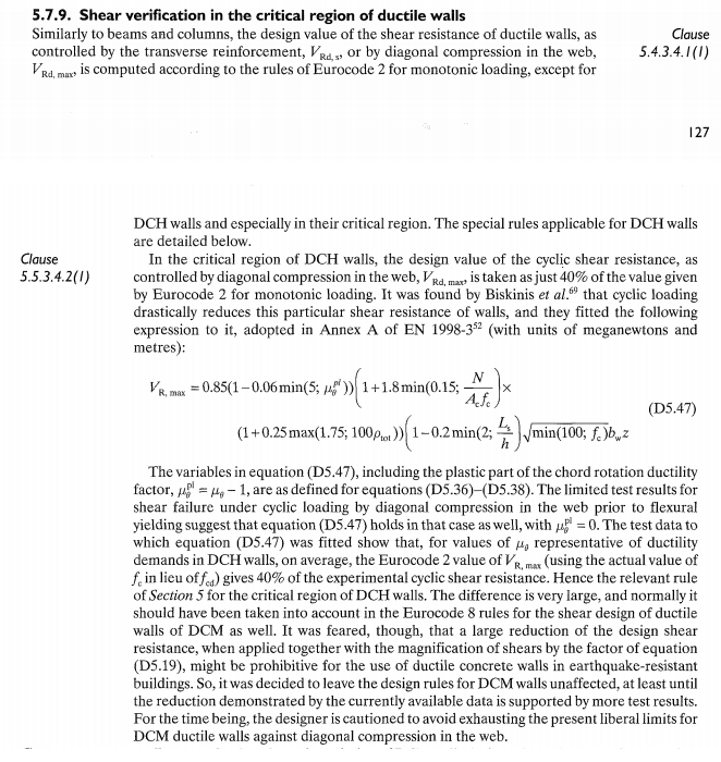

Hello,
this is my first post, I usually watch other threads and find most of the answers so thank you for that.
My question is does anyone here know where the expressions for diagonal compressive failure of concrete come from?
To clarify, I'm talking about the maximum shear resistance that an element can have before the diagonal strut fails under compression, in eurocode it's denoted as VRd,max.
Now, I do know how to get the expression from some basic statics and geometry, but I want to check how the actual experiments to confirm it were done. I want to do this because I think that the expression is valid only for elements with low ductility. Here is my reasoning behind it. In the standard procedure you basically check the strut for failure and it should be the same at any point on the strut, but at the point where the strut connects with the compression area (caused by bending) a 2D stress field occurs. In other words, if bending causes large stresses in compression area, at that point less diagonal stresses can be transferred (basically I check main stresses and not just normal and shear independently).
Why do I care for all this? Well, because of walls in earthquake. Eurocode 8 states that you should reduce this strength to 40% (that's 2,5 times reduction!) of it's basic value for high ductility class DCH (EN 1998-1 section 5.5.3.4.2 if you want to check), but no reduction for medium ductility. Further they say that this is "due to dynamic nature of the loading", but the dynamic nature is present in both ductility classes and usually tests are made by static pushing of the wall so it makes more sense that it's due to ductility.
I'm trying to figure out what really happens because this reduction is HUGE, this strength can not be increased by adding reinforcement and shear failure is non-ductile and should be avoided at all cost. It just feels very important.
I'm sorry if this is not coherent, too long or if I posted it in the wrong place. I can provide way more explanations if needed but I didn't want to put too much in the first post.
If you can give any insight into anything related to this I'd be very grateful, thank you!

I agree and that is certainly the case. The problem is the following, I saw an article from which that provision is taken supposedly and there they had a lot of experimental data and their conclusion is that for high ductility shear compressive strength should be 40% of basic value (that's what the code also says). BUT HERE'S THE THING, according to them for medium ductility (standard structures, like 90% in practice) this reduction is roughly 51,5% (that's their exact number and the code requires no reduction). That's HUGE! Code requires no reduction at all for those structures.
In other words, I'm not really concerned with why is there a reduction of 2,5 times for high ductility, it's why there ISN'T a reduction of 2 times for medium ductility.

I checked the background documents for the provisions given by the code and their explanation is "we didn't want to put any reductions for medium ductility so that wall systems could be economical"
Now just to clarify again, we DO neglect shear strength completely, but that's not my concern at all.
The problem is maximum shear limit (the force at which crushing occurs). I have checked research and I only found some experiments, no theoretical explanation as to why does this limit drop or does it drop with rise in ductility indefinitely or is there a limit.
To further clear it up, I'll try an example. Imagine a wall. You get with standard analysis a force V acting on that wall (let's say it's 2000 kN). You increase it due to "dynamic magnification" (let's say V = 3000 kN after amplification). After that you say strength = 0 and put enough horizontal reinforcement to take the whole increased force. After that you have to check that struts don't crush. You get by your code expression (usually found in a part of code about concrete, not seismic part) that they crush at a force of 4000 kN. You think you're safe, right?
Our code says "if you have high ductility multiply it by 0,4". That would mean that crushing occurs at the force of 1600 kN. Now since 1600 < 3000 it's really bad and it'll fail way before the required ductility is achieved.
But our code also says "if you have medium ductility it remains the same". That would mean that crushing occurs at the force of 4000 kN and that you're safe. In reality it makes no sense at all to me. There should at least be some reduction to it.
Problem here is that if some reduction of that shear strength limit occurs for medium ductility structure, it'll fail in a very non ductile way! And difference between 1600 kN and 4000 kN is huge. The only way to avoid that failure is to require a thicker wall. That changes it's stiffness and so on.
No mechanisms you mentioned before actually influence the maximum shear limit (I think) so I wonder why does it reduce. Because the only documents I could find (most of them research) all say it's because of a dynamic nature of loading.
But dynamic nature makes no sense to me especially since dynamic effects occur even if you design a building to remain elastic.
As I said, I haven't been able to find any research papers explaining this and I've been looking for it on and off for a few years now.

I'm talking only about VRd,max (crushing) so if the geometry and concrete class are the same, yes. So the basic value is the same!
BUT, because of different ductilities, this strength will reduce more for DCH. The question is why does it reduce?
I don't think that final strength should be the same for DCM and DCH, but if the reduction for DCH is 0,4 for DCM it should be 0,5.
Although I think it shouldn't be based only on the ductility class, but I don't know what should be considered.

It's not a safety thing, fardis who you mentioned SPECIFICALLY says that in the designers' guide to eurocode. He says that "similar reduction should exist for DCM, but it wasn't introduced into the code because it would limit the usability of wall systems in practice". That's a very poor thing to do, you can't say "oh it's too expensive so I'll just ignore that this critical thing is in fact half as strong"
RE: Diagonal compressive failure of concrete
I didnt see that one before - I was talking about the Fardis book..Why didnt you put excerpt in the beginning, it would be quicker..everything is written in it :)
Im putting it here if someone wants to continue, but I doubt something better can be found, excluding a email to Fardis or comitee members :)
@klitor
I thought it'd be a lot quicker to just ask if someone knows how the original VRd,max was acquired because the expression given in the picture you provided has a lot of "problems". First of all, ductility stops influencing the strength at a low value (between DCM and DCH lowest DCH value). It makes no sense. Also, reinforcement shouldn't influence the VRd,max at all so what's that all about? Also, reinforcement has no upper value! So if you put a huge amount of reinforcement you could avoid crushing?
I know it's a fitted expression, but it's not even dimensionally correct and mechanisms are kind of unclear.
I've looked at that article they say is the source but it is very confusing, it seems like they used only a few walls of ductility above 5 and a lot of tests were done by an equivalent static method.
I was just curious if someone saw an article explaining mechanisms that cause this reduction or if someone knows how tests are done for the original VRd,max. Because according to the picture you attached this is also true for ductility 1 (or 0 as they say). They also don't mention if this is dependent on the rate of loading (I'd expect that if it's because of dynamic nature). Because if original VRd,max was done only for plastic ductility 0 then maybe the same thing would happen for non-seismic structures when they behave non-linear.
It's also very weird because I'd expect that it depends not only on the current ductility, but also the total ductility capacity.

“we didn't want to put any reductions for medium ductility so that wall systems could be economical"
Isn’t this your answer then?
Not economical if you have to replace or repair after each shake though.
Slightly more economical to build in the first place, but if the first decent shake damages it beyond repair, isn't that false economy?

Well, I was hoping for something that explains the mechanisms that cause the reduction of the strength to better understand it.
For example, if you ask why does shear force increase, there's a logical explanation that it's because energy is usually dissipated by bending in the first mode, but not in higher modes so influence of the higher modes on the shear force should not be reduced.
This example has nothing to do with resistance, but I just wanted to show an example how there's a certain logic to it, you can understand why is it happening.
I don't like provisions that just say "oh, reduce this 2,5 times because I said so", especially if it's because of a certain phenomena and not a safety thing. Because there is a logic behind it, it can be explained.

There is a known degradation in shear capacity with increasing curvature, it's not something someone made up for no reason, i.e. something like this:-
This reduction is the outcome of many of the contributing factors noted in discussions above with respect to shear capacity at higher ductility/curvatures in plastic regions.
EDIT- added this as it explains it in words:-
The text they refer to is this one:-

Yeah, i know it's not made up for no reason. Thank you for a suggestion on reading material. I've already seen this book many times, but was never able to get it.
The graph kind of makes me sceptical, this expression is used for determination of shear strength if failure is due to tension. I think I read one of the articles mentioned in the text and it was tensioned based failure. I attached a picture to show what I mean by tension or compression failure.
I seem to mention this a lot, but tension controlled failure means nothing because in design you consider Vc = 0. You don't however consider Vc,max = 0 (or VRd,max or Vu,max). You can't influence Vmax by adding any type of reinforcement, just by changing the thickness of a wall.
Since those are different mechanisms, their degradation shouldn't be the same. For example, due to dynamic nature the cracks smooth so mechanical interlock becomes weaker. While that may be important for tension controlled failure it doesn't make any difference when talking about compression controlled failure.
I'm sorry if I don't make much sense, I don't know, maybe I think there is something that doesn't exist.

As a matter of fact, here is an article (I found it on the site of a uni so I guess it's openly available) http://www.strulab.civil.upatras.gr/sites/default/...
Look at the chapter 4. You can see that there are different expressions for shear in tension and compression and their strength reduces differently.
In fact, look at this formulas taken from eurocode, this one is for tension controlled shear failure
k takes into account size effect, ro is the influence of longitudinal reinforcement, sigma is the influence of axial load
Now look at the expression given for compression controlled failure
alpha is the influence of axial force (okay, same or similar mechanism as in tension)
ni is the influence of cracking
theta is the influence of strut inclination (doesn't exist in tension failure)
where is the influence of longitudinal steel???
This expression shown in the second picture can easily be derived from simple statics and geometry, just see when you get compressive strength on a diagonal because of shear force.

All I tried to say by "different mechanisms" is the following. Consider the picture
both of these can fail either by one triangle sliding on the other along a line or curve.
Another failure can occur by crushing of the diagonal.
Now, both of these will crush at the same force, but won't slide at the same force. That's all I meant, that some things that are important for one type of failure aren't important for other type. So if you say that reduction of sliding capacity occurs because the bottom pic became top pic, crushing won't care because it's independent of the roughness of the crack. So one of them can decrease without the other one decreasing.
