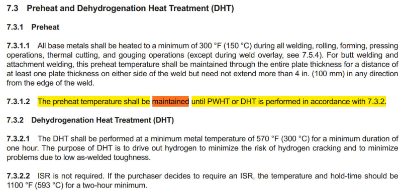

I was reading API 934 C for a new project in our company and I have some doubts with which you might help me.
API 934 C Ed.2008: 7.3.1 All base metals shall be heated to a minimum of 300 °F (150 °C) during all welding, rolling, forming, pressing operations, thermal cutting, and gouging operations.
Here the RP uses the word "shall" making it mandatory to preheat the shell material to 150 C before rolling. I find it really difficult to heat the whole shell up to 150 C and maintaining that temperature during all rolling. Have you ever faced this difficulty before? Please share your idea regarding the issue.
Apart from feasibility of the process, I want to know about the possible benefits of this preheating before rolling.
Also the RP continues with a sentence that is even stranger to my eyes. I highlighted that in the image below.
Please tell me what is "maintaining temperature" in this context?
Warm regards
The minimum preheat temperature is not reduced until the PWHT or dehydrogenation treatment is begun. All of the recommendations shown state "should" not "shall".

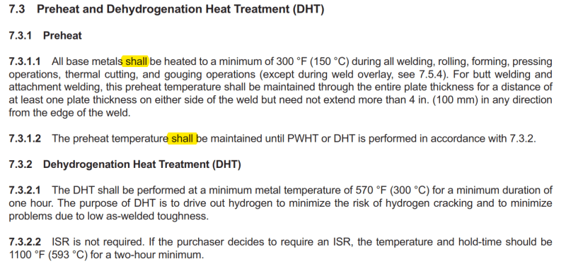

I uploaded the 2008 edition of the RP. However in the 2019 edition the word "should" has changed to "shall". This shows that they have considered it to be more important than they thought before.
weldstan, is it possible that I give the plates a dehydrogenation heat treatment and omit all later preheat before rolling or forming?
No. The purpose of the dehydrogenation treatment is to lower or eliminate hydrogen induced by welding. After the dehy treatment, you can PWHT at anytime thereafter.

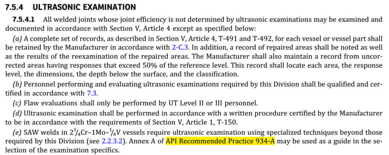

DekDee, the owner of the equipment has asked conformance with API 934 as a mandatory requirement. Besides even if they had not asked for it, in order to give an acceptable fabrication procedure or inspection and test plan or other issues it would be necessary to follow all good practices known to the industry. Actually there is a reference to API 934 A in VIII-2.

Again back to my question:
What is meant by the word "maintain" in the following highlighted text?
If it means that the temperature shall be above 150 C throughout the whole fabrication process it really freaks me out since that is definitely impossible (at least in our shop).
If it means "The minimum preheat temperature is not reduced until the PWHT or dehydrogenation treatment is begun" as weldstan mentioned then it can be interpreted that you can give a dehyd treatment and then start rolling or forming the shells at lower temperatures.
I do not want to eliminate preheating for welding, but I definitely want to get rid of it before forming.

The word "maintain", in this section of API 934C, means you don't let the item being worked drop below it's preheat temperature until it can be DHT'd or PWHT'd. I've been involved in the fabrication of HEs and PVs that had API 934A or C applied. They are quite challenging.
Paulettaa does have a point. Forming does not introduce any hydrogen like welding does, so why does it group them together and required PWHT or DHT after forming. Seems like it could be just poorly written to me.
I completely agree it's poorly written and the forms of heat-treating it communicates are unnecessary for forming. In the rare even that a customer interprets this as it's written, we will take "exception" to it.
