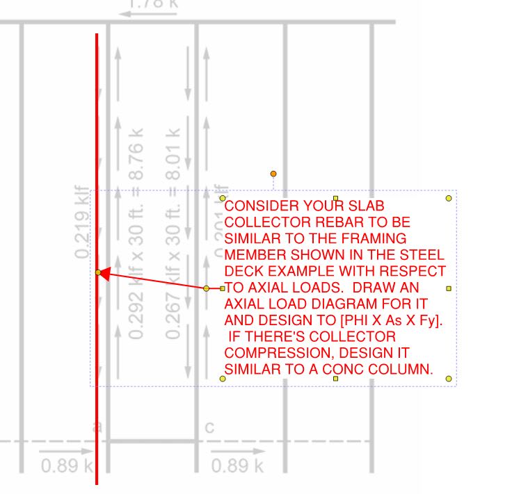

I'm trying to design the required reinforcing steel around a cast in place diaphragm opening. I used the reinforced concrete design handbook, SP-17(14) for the chord steel, it does not tell you how to design the collector steel at the opening. The only example I've been able to find is this one for a steel deck. ( https://www.structuremag.org/?p=577 ) Lets assume the diaphragm in the link is concrete and the forces are the same; am i designing the collector steel at the opening for the 8.76k reaction?

Ok. Let's start general and then get specific as required. The sketch below shows the general process.
How to do this in CIP slabs is a bit nebulous for a few reasons:
1) There are multiple ways to do it in CIP decks.
2) Until recently, we didn't really worry about this in CIP decks as they're pretty robust with respect to these types of actions.
3) The high seismic detailing discussed in the NEHRP doc is often poorly received by construction teams in jurisdictions where seismic is less of a concern. If it's me and it's not high seismic, I'll bend over backwards to tell a story that doesn't require ties around the collector bars.
Is your situation high seismic or closer to the conventional end of the spectrum?

Seismic is category B. Based on that example the collector is taking the 0.219k/ft * 120ft = 26.28k/(.9*60ksi) = 0.48in2 of reinforcement steel? I don't know why but it seems excessive to me, then again i dont have any experience with this...

Although you're right, I believe that you've grossly overestimated the net tension.
I highly recommend drawing the axial force diagram for the collector, considering what's gong on on both sides of the collector, as I recommended in my second post. If you haven't done this already, I suspect that it will be a worthwhile exercise. And, if you post the result, we can probably get you straightened out on this.
