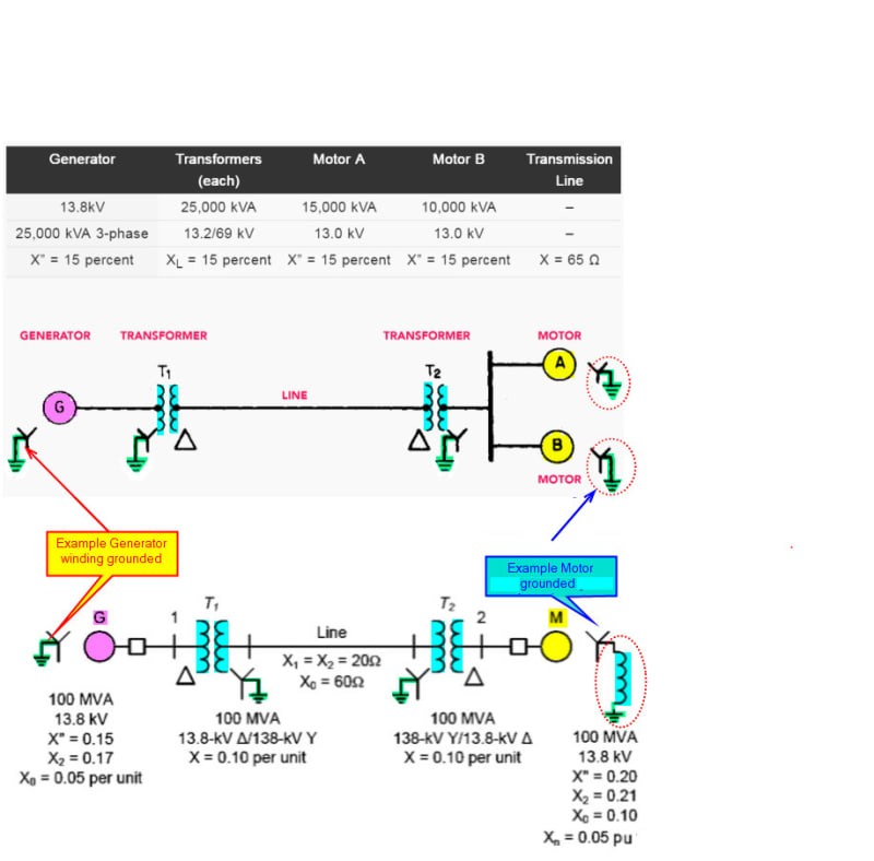

Enclosed is the requested reference and additional illustrations on motor neutral grounding found in the net.
I hope you or someone else bring some light to this subject.
The graphics you're showing are for academic exercise only. They are not how power systems are typically designed. If I remember right, the first is used in a chapter teaching per-unit analysis, the second is used in a chapter teaching asymmetrical fault analysis using Thevenin-equivalent networks. Even though I used those diagrams while teaching because they were in the book(s) I used, I always pointed out the issues in them to my class when we went over those problems. I cringe to think about how many professors don't know there are significant problems in the diagrams and use them as-is. Just because a textbook shows something it doesn't mean it is correct. Where did you find these?

I'll be honest - I've seen some really big motors but nothing in the 100MVA power range.
The only reason I can see for grounding it is because the transformer winding is delta, but I could flip that logic around and say the transformer is a delta to suit the motor. At that size the motor will have many similarities with a generator - it would pretty much have to be a synchronous machine - and earthing the star point makes sense to protect the stator core. I can't help with the reasons why you'd choose a reactor over a resistor (or 1-phase transformer with a resistor burden on the secondary). As xnuke says, that looks like an academic exercise - any motor of that size would be noteworthy.
To separate this issue from an academic exercise, below is an excerpt from the IEEE Press regarding a classical stability publication on "Effect of Grounding on Stability". The author, Mr. Kimbark is a worldwide subject matter expert in this area.
Should be noted that system stability is not a major concern in most industrial application and even for the bulk electrical system, there are several options more popular than ground the neutral of large rotating machines.
Fill free to challenge the merit of this publication with technical arguments if there is no benefit of increasing system stability following the advice of grounding the neutral using resistance at the generation end and reactance at the motor end?.
I think the author himself had pretty much made the arguments in his last two lines.
