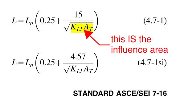

2) Abandon this ridiculous notion of Kll and At being separate variables because ASCE thinks that you're a helpless child. Instead, consider them one variable and define it like this:
A_influence = Every damn square foot that could be loaded and would result in some load winding up where you're concerned about it. Trust me... this is better. And righter.

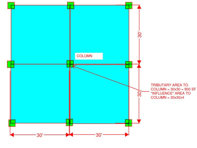

4) For slab flexure and one way shear, A_inf = 30' x 60' x 4 = 7,200 SF
5) For the axial component of punching shear, A_inf = 60' x 60' x4 = 14,400 SF.

Koot - I'm not following the 60x60x4 for the influence area. For axial punching shear wouldn't it be 30x30x4 (given the bay size of 30x30)? Otherwise, I agree with your analysis.
RE: Concrete Podium Design Live Load Reduction
Quote (CURVEB)
How so? We're both considering an interior column, right? If so, it seems to me that 30x30x4 is actually the tributary area rather than the influence area. I believe that the influence area would always be more than the tributary area for a column except, perhaps, if the structure somehow only had a single column. Certainly, it would seem odd to me for the column influence area to be less than that for one of the imaginary girders tying into it.

Koot - for an interior column, I would think you have 4 30x30 bays, 1 at each corner of the column, like so:

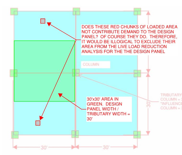

I object strongly.
Firstly, whether or not you think that live load reductions ought to be based on influence area, they most definitely are based on influence area in ASCE7. KLL x AT, the very parameter that enters into the live load reduction calculation, IS the influence area. So there's that.
Secondly, from a theoretical standpoint, I believe that it is much more rational to base live load reduction on influence area as opposed to tributary area. Live load reduction is obviously a statistical thing. The more loaded area that contributes demand to a member, the lower the likelihood that that all of those loaded areas will see their maximum load concurrently.
Since influence area, by definition, represents every square foot of area that would contribute demand to a member when loaded, it's the perfect tool for such a statistical analysis. And, by contrast, tributary area would be a more flawed tool for such a statistical analysis precisely because, on it's own, it does not reflect the total loaded area that would contribute to member demand.

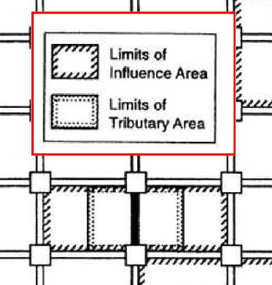

I disagree. Let's try it another way. The sketch below is taken from ASCE7 commentary. Do you not agree that it suggests that the influence area for our case would be 4 x 60 x 60? I certainly believe that it does. And this would be entirely consistent with the KLL = 4.0 commonly used for interior columns and specified in ASCE7.

I disagree. Again I think that this is to mistake tributary area as the appropriate tool for statistical, live load reduction analysis when it should rightly be influence area.

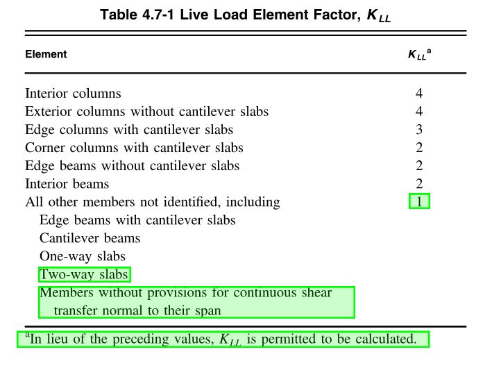

ASCE7 table 4.7-1 lumps two way slabs into the category of "other crap" with a Kll = 1.0 (trib area) unless you go and calculate KLL. I take that to simply mean that live load reduction for a two way slab is a bit complex and requires one to put their thinking cap on based on a fundamental understanding of live load reduction. So Kll = 1.0 unless you go and put your thinking cap on which is, of course, what we're doing here. I'll note also, that per the table below, a two-way slab does indeed have the ability transfer shear perpendicular to its span as that is the very definition of a two-way slab.
Again referring to the ASCE7 commentary sketch, does the clip below not suggest that the influence area for slab design for a 30' x 30' layout would be based 60' x 30'? It does to me. Yeah, it's beams rather than flat plate. But, as I mentioned at the top, you pretty much need to think in terms of beams in order to make rational sense of this stuff.
I think we are in agreement that 4 bays contribute to the influence area for a column axial load, what I'm not following is why you are using 60x60 for the bay size. With columns spaced 30' apart, I think the next bay starts beyond this point, so I don't get how you can include it. I would think no portion of the slab beyond 30' from the element you are looking at (the column in this case) has an influence on the load, unless you start to consider slab continuity.
Quote (curveb)
...what I'm not following is why you are using 60x60 for the bay size.
I'm not. 60x60 is the size of the influence area. Think of it as (2x30)x(2x30) if you prefer. For an interior column, the influence area is bounded by a box two bay sizes long in each direction.

I was not aware of the current definition of influence area, i.e. KLL*AT. It would appear that, for the design of a column, KLL = 4. Therefore, I accept KootK's conclusions with regard to design of a column.
However, the OP was concerned about the design of the podium slab. For a two way slab, KLL =1, so Influence Area = Tributary Area. My response to the OP's question remains as before, KLL*AT = 1*4*30*30 = 3600 SF.
