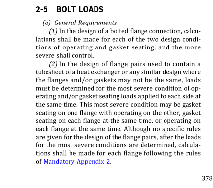

CuMo. Please read ASME VIII Div. 1
When the tubesheet is gasketed between the shell and channel flanges, the shell and channel flange
bolt loads are identical and shall be treated as flange pairs.

Extract from ASME VIII-1 Mandatory Appendix 2
r6155, the code is very specific about what needs to be done in this case. There is no need to "treat" flanges one way or another.
If his software doesn't cover it automatically (as some don't and others do) he might end up in a very stupid situation.
