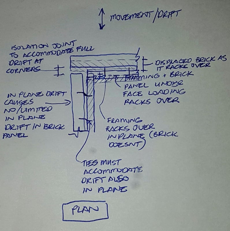

interesting link there regarding joint reinforcement at corners. the link
few ideas to kick around:
1. the shake table testing mentioned above by masonrygeek resulted in the ACI standard removing the requirement for joint reinforcement. based on this, I can agree with removing joint reinforcement along a regular run of brick wall. But perhaps there is a case for limited amounts of joint reinforcement around corners in lieu of control joints?
2. perhaps there is a case for limited joint reinforcement in lieu of control joints at openings? as mentioned in page 10 of this manual?
3. Also wondering weather "rigid" ties are actually better than corrugated ties. as per section 5 of the paper put forth by masonrygeek - it noted that rigid ties did have a higher capacity (1.2kN/tie) than corrugated ties (0.85kN/tie), though the rigid ties failed more "suddenly" ie, maybe corrugated ties are more ductile?

As to whether you put vertical movement joints near the corner as Agent666 mentions or joint reinforcement at the corners to strengthen them, you have to go back to what you are trying to accomplish. Are you trying to let the veneer and structure move during a seismic event or are you trying to stop the movement from happening? Ductility is what is desirable in earthquakes so you probably want to allow the building to drift (assuming its a 10 story building) and not impact the veneer. That means you are creating panels of brickwork with shelf angles at every floor and vertical movement joints (called isolation joints in this case) maybe at corners to allow the movement to occur. When you place joint reinforcement in the veneer at the corners you are stiffening up the veneer which will attract load. So that may not be the best choice.

I'd only put the corner reinforcement in a residential low rise (1-2 storeys) where the drifts are typically very low (less than 1% typically). Tying it together around the corner otherwise should be avoided. What I was trying to say regarding the vertical 'isolation' joint is nicely summed up by masonrygeeks 2nd paragraph above.
See sketch below to reiterate this issues with brick accommodating the full drift at the corners, note this can mean quite wide isolation joints, if you have 50mm interstorey drift, then the separation needs to be 50mm, and the ties might need to accommodate 50mm of relative lateral movement (make sure the architect understands what these joints might look like). So the overall magnitude of the drift is quite important (you may need a relatively stiff structural system to get the cladding and ties to work as a complete system). It's no different to precast cladding and isolating the panels form one another to be able to accommodate the drift, you just have the additional complication of the ties needing to accommodate the in-plane drift:-
I am with you Agent666 on your detail above being the preferred detail for a corner. though architecturally, this is a tall ask - foresee a real battle with the architect.
important to note that the movement required must consider the allowable movement of the silicone used at the joint. The most flexible sealant I am aware of - Sika Hiflex - only allows for +/- 25 % movement on the spec sheet.
So in theory, if you are required to have 50mm of movement, you would need a 200mm sealant joint. Problem is, the largest allowable sealant joint that Sika allows is 1.5", thus, the maximum movement allowed would be about 10mm. conveniently this is about the most movement I would be comfortable with anyway on a brick veneer
You can get other types of 'prefabricated' isolation joints that may work for wider gaps, though I'm struggling to find anything to show an example of what I mean for a wall. But they are perhaps more appropriate for wider seismic gaps between separated structures rather than single isolation joints in brick.
I don't think anyone would be keen on even a 50mm sealant joint in terms of how it looks!
If it doesn't work structurally then sometimes the architects just need to join reality rather than live in a dream world where impractical things work because its what they want. If they have a problem with it see if the architect would like to be hit on the head by a brick because thats what it comes down to potentially. Either create sufficient separation or risk it all going sour when stuff starts moving and locking up.
