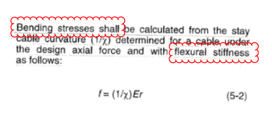

I am designing a new post-tension system for an existing timber truss. A requirement from the stay cable design guide (PTI DC45.1) is I include local bending stresses from the turning points of the post-tension wire in addition to the axial stress.
When I calculate the bending stress per the equation provided (see below), I am getting 6200 mPa of stress which is way above the specified tensile strength of the new 7 wire strand I plan on using (fs'= 1860 mPa).

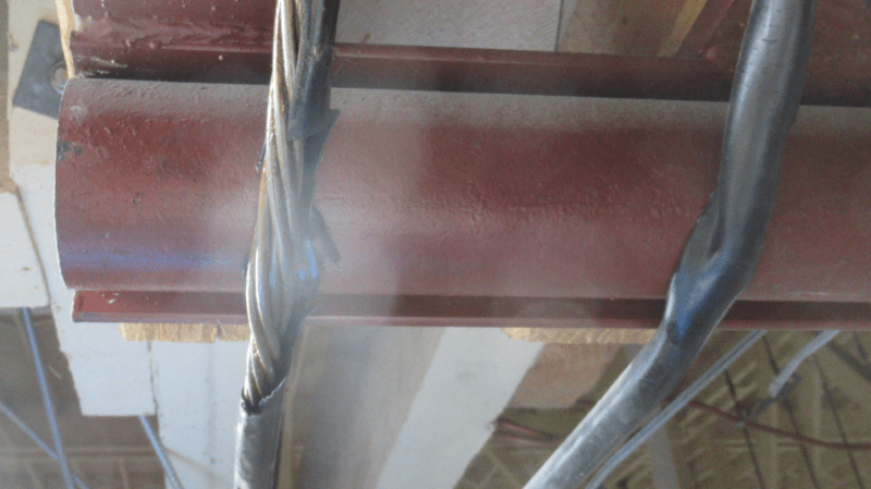

I find the radius of curvature of the turn is too tight but the existing post-tension system on the timber trusses have a tighter radius of curvature which clearly works. I was wondering if anyone can provide me comments on how this works and how I can make it work with the same turning point. Thank you.
This is a picture of the existing turning point.
This is the formula from PTI.

f is a flexural STIFFNESS (units of MPa) and not a bending stress (also units of MPa).

I disagree with the assertion it's a flexural stiffness. Wrong units for a start. The equation is a strain times young modulus, this equals stress. (see the link I posted as it derives the equation)
Now the issue is this equation is suitable for solid sections (like a solid bar bent at a radius), and not suitable for helical wound strands as there is inherent slip between the strands that results in a low flexural stiffness compared to say a 12.9 diameter solid rod, which if you bent it to a radii of 130mm would clearly exceed the yield stress. Which is exactly what the equation is telling you.

I would have thought a flexural stiffness has kNm/m/rad units?
I think it means calculate for a cable (with bending stiffness) the stress as follows. Just seems poorly phrased?
Throwing it out there also that EI = bending stiffness = N/mm^2 * mm^4 = Nmm^2.

Thanks Agent666 I will read that document. I also agree with you. I know for a fact that the derivation of the normal stresses generated by flexural bending of a beam is the same equation as what's shown in the guide, which is the inverse of the radius of curvature multiplied by the modulus of elasticity and the distance between the extreme fibre and the neutral axis of the beam. Also, flexural stiffness or rigidity have units of Nmm^2.

The existing trusses have an 8mm diameter post-tension wire (solid) as shown in the picture. I don't think it's any different than a beam in flexure but I could be wrong. Bending those existing wires to that curvature would have yielded the extreme fibres of those wires followed by the addition of the actual post tension stresses. I don't know if the bending stresses can be ignored similar to stirrup reinforcement where the rebar is bent 90 degrees, or if the equation is limited to small strains or curvature. I did find a recommendation in the guide suggesting a minimum radius of curvature of 2m
I agree there would be a slip in the helical strand if bent to that curvature, which I believe the guide takes into account by allowing you to use the distance between the centre of the king wire to the centre of the outer wire instead of the king wire to the extreme fibre of the outer wire.

Below are pictures of a similar configuration but from a different building.
You can see the strand/s actually unravel at the turning point and the cover is ripped. I'm concerned this is due to the bending stress (and/or bearing stress?), which may or may not have been taken into account during the original design of the existing post tension system.
The document Agent666 provided shows a short and simple reduction factor in the axial capacity to take into account the forced bending stresses on the strands. It seems rational and it compares well with tests results so I think I'm sticking with that formula instead of the PTI formula, which appears to be limited in application. Thanks guys.
To prevent/minimise the unravelling, I'd think you could feed it through a steel guide pipe of a similar diameter which is bent to the correct radii? Weld it to the anchor block thing if needed. Sort of becomes a long term durability issue if its lost the protective sheath around the bend.
Yes, that's what we were planning on doing. We're going to install a steel guide pipe to try and confine the wires. I sort of drew it in the second picture just below the equation from PTI. Thanks for the input Agent666 much appreciated.
