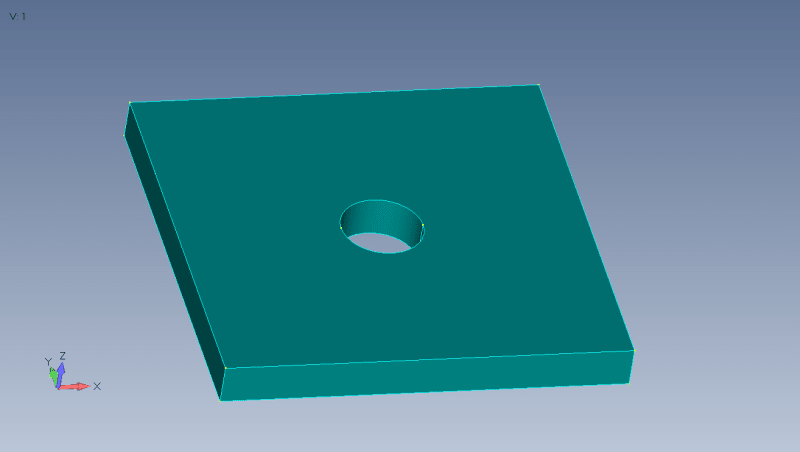

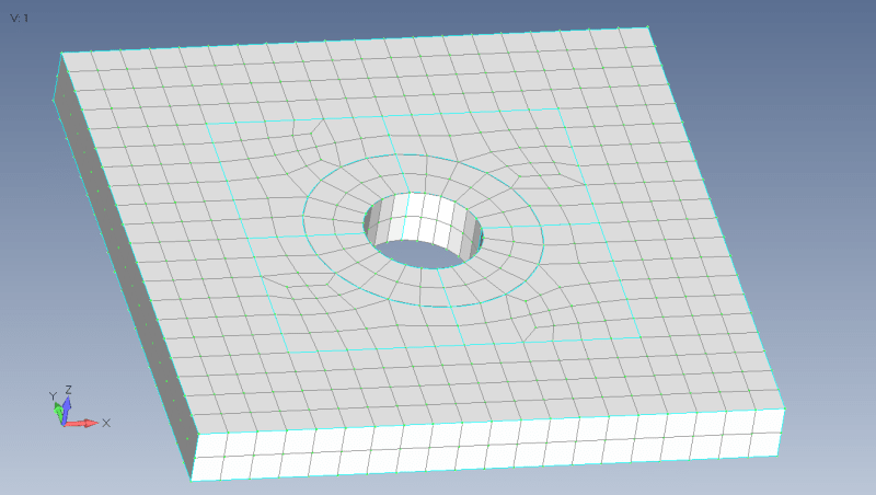

Imagine something like a plate with multiple holes in it. Looking at the image below, if I use the "Mapped Hole" mesh control, I get something like the mesh on the left. What I'm trying to get is the mesh on the right. :
(source:
When you talk about defining a Region, do you mean it at the FEM file or CAD file ? In the FEM file, the best I could do was to create a Circular Imprint, but that didn't make that much of a difference in comparison to the "Mapped Hole" result.
Keep in mind that the holes are just an example of my problem, that is, not being able to divide my surfaces on the go in whatever way I want to manually refine my meshes.

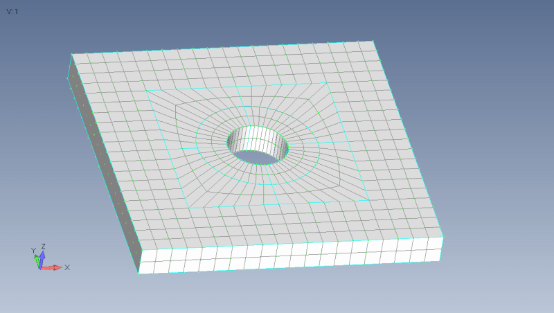

I`m not NX user but I think that you should chop geometry onto regular sweepable blocks to achieve neat regular mesh. Put mesh sizes on selected curves manually.
In addition check how distorted regular mesh at third picture. Regular mesh is not good in any cases, refinement only around holes, like at second picture, look like good choice.
Thanks karachun, that's what I was trying to do. I guess the easiest path in NX 11 to chop the geometry would be to create sketches in the "Modeling" application and then apply "Divide face" with the sketch to obtain multiple faces. Then, and only then, you would have some kind of boundary in the geometry to achieve better manual refinement. I was looking for a quicker/shorter workflow, like in Femap, but I guess there isn't one.
