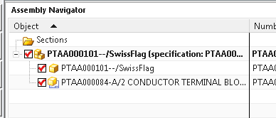

Your component is not really in the Drawing "Assembly" structure. You used the View from model to place the view.
Here you can see the difference. The top Component is added as a real component to the Drawing Structure. (this is done automatically by NX when you create a new drawing from a 3D model)
The bottom "component" is added as a view later on (the difference is in the icon). It is not really there it is just referenced. If you look in the properties you can see that it is set to reference only.
Therefor you can't replace it. There is nothing to replace.
If you want to be able to replace the components in the future, then you first need to add them (like in an assembly) and then afterwards create the views for it.

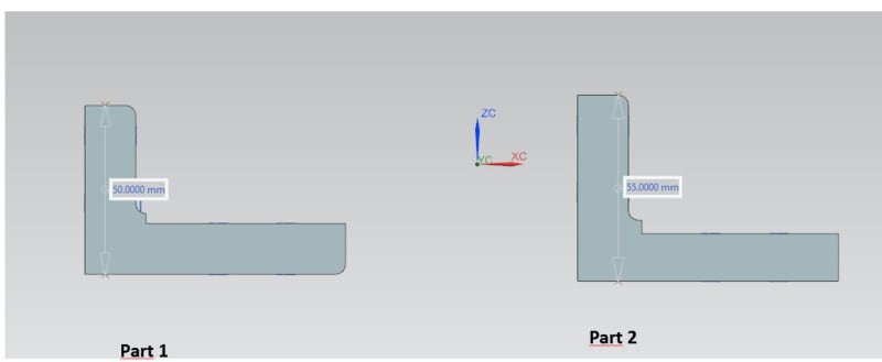

I will repeat the issue with a new picture; My design has a couple of a very similar parts ( part 1 & part 2)
and I must create a single drawing detail of each one I order to be able to launch and mechanised it…
In an previous NX Versions as NX6 to NX8: I made a drawing of a part 1 for instance and once it was finished and
I wanted to create a drawing for a part 2 ( I repeat, avery similar part) starting from a drawing of part 1, it was
very easy through command Replace component in a view...
I have realized that this way to handle similar cases is not functional with NX 10 version....
According your words... Must I foresee to create a component with a similar parts in order to be able to replace them
in drawings?

Application "Replace component" does not allow me to select the component to be replaced...
In your Assembly Navigator
What happens when you touch (with your mouse pointer) UTIL_ENTRADA_SFF_825_519_GR04_002 ?
Jerry J.
UGV5-NX11
The yellow cube icon denotes an assembly component; the yellow cube over a drawing page indicates a drafting component. Drafting components do now show up in the graphics window when you switch to the modeling application nor do they show up in a parts list on the drawing. These views are mainly used for reference. In older versions of NX, you could use the "replace component" command on these views. This was intentionally removed in NX 9; no equivalent command has been added to enable what seems to be a common need.
There is a bit of a trick to "replace" these drafting components, but dimensions and annotations in the view will likely lose their associativity. In the drawing, add a base view from the part that you want to see in your drawing, right click the existing view that you want to replace, go to settings and expand the "inherit" section at the bottom (if needed), change the settings source to "selected object" and select the newly added view of the part you want to use. The existing view will update to show the same part. Delete the newly added view and reattach dimensions and annotations as necessary in the existing view.
