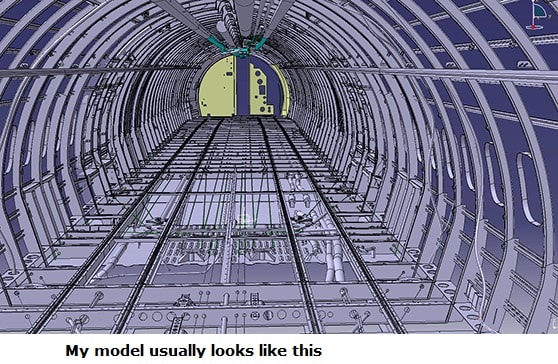

What do my models look like? See below for a taste. Not mine but very similar.
Models I use often have 10,000 parts to fling around. Some of the parts are in a new system being installed, and many others are just "there" to show where the new parts are supposed to go. If you were modeling this, you would want the new parts to be sufficiently detailed to accurately represent their assembly. If we are manufacturing the parts, then they're as detailed as they need to be to represent all of the features to be fabricated. On the other hand, the surrounding parts just have to be there to display the shape and position of the surrounding structure to which the new system is attached. Those parts need no more detail than the drawing needs to see.
To make enormous assemblies smoother, I reduce them to a few thousand or few hundred by use suppressing what's unnecessary. The underlying assembly has to open at least once so that I can isolate the parts needed for the job at hand. All I need is the CONTEXT to do a system routing, perhaps spanning the entire length of the airframe. Other times I may be cutting apart a number of those frames, or hanging new stuff from them. I am not having any trouble at all with this part of the transition to Solidworks. Models are easy in SW and relatively intuitive. That part of the transition has gone well. And I've always had the impression (maybe not accurate) that Solidworks is geared for models more than drawings.

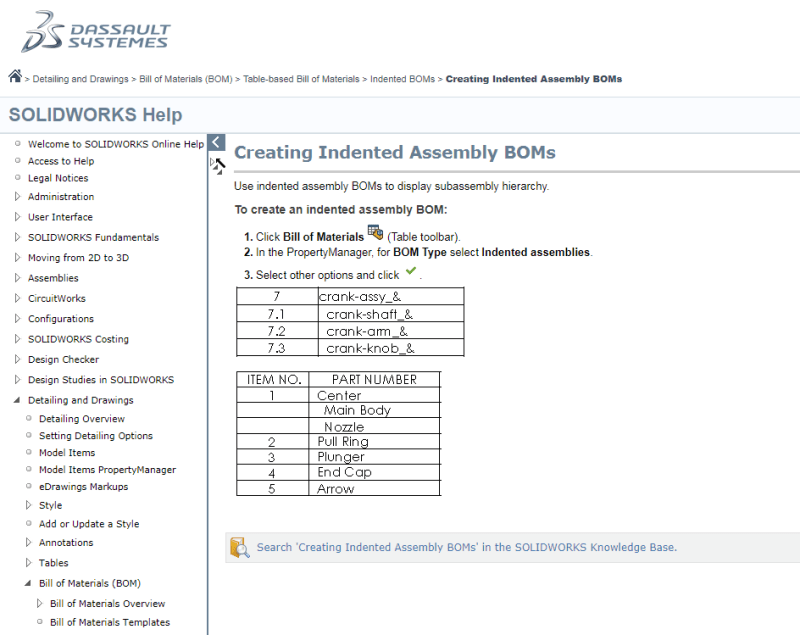

Do you ever include a hierarchy in your BOM's?

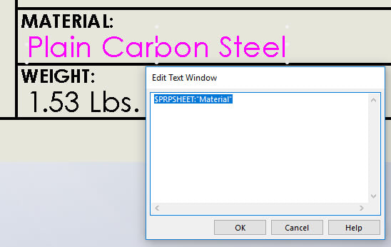

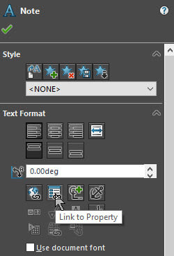

You can create custom properties and that opens up other options. For example, the production machines I design for my employer are built by outside firms. We expect them to purchase most commercial items as part of their scope. Sometimes there are some very expensive or proprietary items that we will provide. I added a custom property to the part template file that we use to show when a part will be provided by us. Then added a column in the assembly BOM template and linked it to that part property. So now the machine builder has a direct indicator of what parts we will provide to him.
There are also direct controls for line formatting and styles (Options, Document Properties), as well as all the other topics you mentioned. Spend some time in training, research, and as you have done in the past, asking questions here.

2) Hierarchy - I assume you mean indented BOM, where a Sub-assemblies lists all the parts within. Yes I do, mainly for our shop guys, not customers

5) Check out Indented BOM's in the help.

...You can create custom properties and that opens up other options. [...] I added a custom property to the part template file that we use to show when a part will be provided by us. Then added a column in the assembly BOM template and linked it to that part property. So now the machine builder has a direct indicator of what parts we will provide to him.
I tried to set that up, too, but something went wrong. I'll have to circle back someday to that subject to try again.

"Indented BOM" kinda, but not quite.
Each assembly drawing in my industry tends to "create" a new assembly number using the part number - dash number combination in the BOM.
When I'm working on drawing 12345, and the first assembly is labeled -01 in the part numbers column, then the assembly's complete part number is "12345-01".
On such drawings I can (I DARE!) to put multiple assemblies, creating multiple assembly part numbers. Some assemblies nest into other assemblies, even. Now in the BOM you find more -02, -03 and so on, and that generates many separate assemblies with separate part numbers, all quite distinguishable from each other. All of my shop hands understand and expect this. I have not yet found a convenient way to generate such a BOM structure in Solidworks. I have to use lots of custom rows in the table. Nobody else in the office knows how either - I asked.

Default fields in view titles: Every time I place a view, the title under it is "SCALE 1:1". No thanks, that's one piece of information that I NEVER keep on my drawing view labels. Where is the Part Number and Part Description? All of my models have the p/n and description entered in the document properties, and they appear in the BOM well enough. Why can't this be put on the view title?
On such drawings, I can (I DARE!) to put multiple assemblies, creating multiple assembly part numbers. Some assemblies nest into other assemblies, even. Now in the BOM, you find more -02, -03 and so on, and that generates many separate assemblies with separate part numbers, all quite distinguishable from each other. All of my shop hands understand and expect this. I have not yet found a convenient way to generate such a BOM structure in Solidworks. I have to use lots of custom rows in the table. Nobody else in the office knows how either - I asked.
BTW Inventor was not good at this either - but we did have a macro that would set it up for you once you had the assembly views placed on it.
To my knowledge that is the extent of what SW can do with an indented BOM. It might be possible to do what you are asking if you knew how to write your own program using SW API.
Yes, I use Phantom lines when it's appropriate.
I assume you want your fields in the drawing to auto-populate with Part number \ description? Click on the "link to the property" and select the "property". Such as "Part Number", "Part Description" etc...
If you have a drawing and a model loaded into the drawing and say something is incorrect, you can RMB the annotation and select "Edit text in window". There you can see the link text information to ensure you are pulling the correct property. You can also see how to write it into the fields manually, but you have to do it from the "edit text window".
As for your scale, you just don't have any of the drawing templates set up correctly or linked correctly. Understanding how drawings templates and how to link is not simple and takes time. You are going to spend a lot of time in your help and on here looking for your answers. I am sure your questions have already been asked on here from years past. Honestly, I don't think the basic function of SW drawings has ever changed. They have added several new items to drawings, but how it works and links is still the same.
Drawings have 2 layers to it. "Sheet format" (*.slddrt) is one layer and the other is the "Template" (*.drwdot) itself. Knowing that the template uses the sheet format and all its links, is half the battle.

A quick thank you for a number of tips that I can use right away.
Going further with item balloons within a block of text... indeed I never found a way to to that in Inventor.
This could be very handy. Can I also cross-reference my way to the item's part number too?
Imagine being able to write:
"Apply adhesive [EC1367] to top face of [plate] [121212-03] uniformly using brush applicator."
...and link the name of the adhesive from the BOM and link the part name and number from an item reference. Then if the selection of adhesive has to change the reference in the note updates along with it!

I recently took a SolidWorks assembly model, and I created a document with assembly process instructions, nine pages long. It worked pretty well.
Item numbers are intelligent. You can click on them and add them to your notes. Everything updates intelligently. You can click on parts on the views and extract the descriptions intelligently. I like to define parts as assemblies if there is any change there will be pins and thread inserts. This messes up clicking for descriptions.
I did not use configurations to create the drawing views. I used the named displays and views. SolidWorks supports multiple exploded views.
I wish the text editor was smarter. I would like to parametrically refer to note numbers. I had to define each page with its own drawing views and separate notes. SolidWorks is not a word processor.
