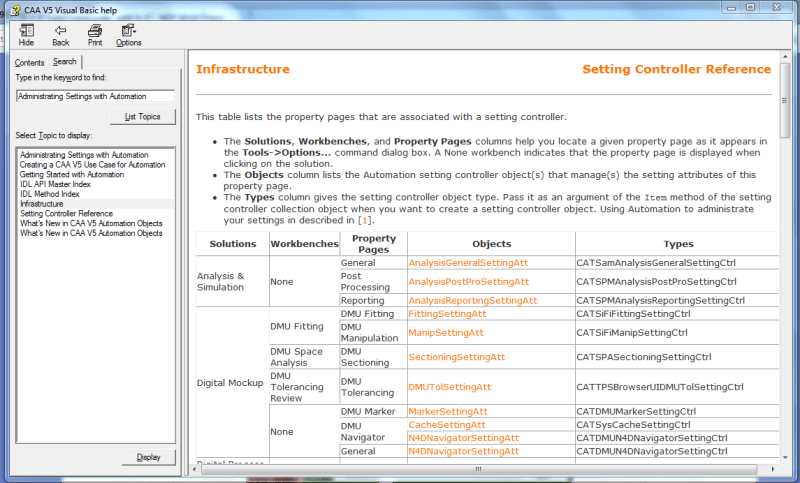

So, I really want to know how and from where did you find the value 'DYS_settings_UnderDefUpdateErr'. I was not able to find it in the help file either.
Thank you ferdo, but I am aware of these resources. I posted because but I was not able to find the sketcher tab mentioned in the help.
In the options dialog - Mechnical Design > Sketcher > Sketcher
In the help table, I expected 'Sketcher' to be in the second column of the Mechanical Design solutions row. But it is not there. In fact I can't find the word 'Sketcher' on that page containing the table.
What am I missing?
Or not all the settings exposed?
