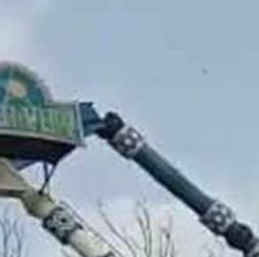

That was such a... well behaved failure. It's fortunate it didn't fall off landing on an edge or it would've created a bunch more carnage.

When stepping through the frames at about 7.0s it looks like the steel plate is tearing just above the connection.

Articles keep saying a cable broke. I don't see any cables on the ride before/during failure but there could be a cable lying on the ground in the after failure shots. Were there cables helping to support it?
I think the cable thing is a red herring. the ride is clearly working normally gradually speeding up then simply broke.

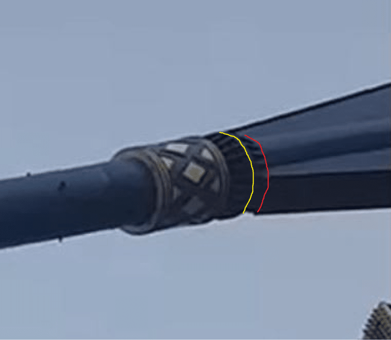

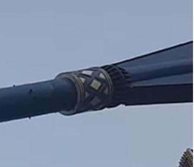

It looks like the shaft was bolted onto the main cetral point, but seems to have broken above the flanged joint if you look at the two photos below, the break point seems to be well above the colourful collar.
the "reinforcement" of the flanged joint looks rather odd to me - I wonder if there was some previous damage or the designer recognized that the joint was under a lot of moment.
Reasonable hi res image before the accident
The break point in lower res video still
Lots of stress reversal and fatigue potential on that joint and repetitive acceleration changes. Would the loads be similar to an impact load of some factor (2x, 3x?) gravity?
Yes. Looks like the stiffened bulb remained intact, and it failed just beyond that. Makes sense. Sudden change of shape, with lots of potential stress concentrations and fatigue points.
