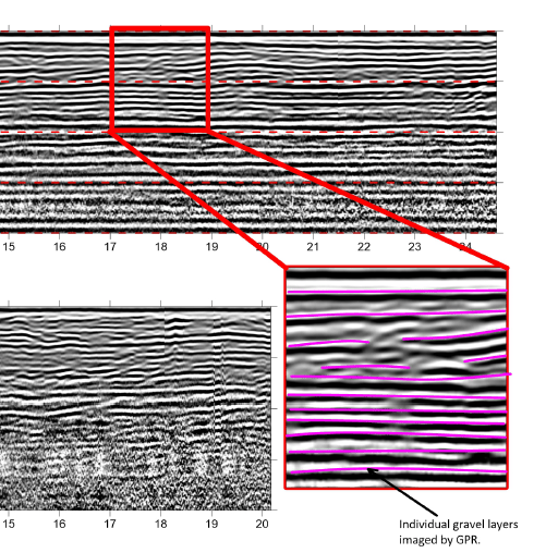

As well as the SPT test, MASW testing and GPR testing were carried out on the embankment. MASW showed the stiffness of the material in the embankment and the level of consistency in this, and GPR was able to identify the individual compaction lifts to ensure the correct lift height.

Id be interested to know what Vs values you were getting in the embankment and also how GPR showed the lift thickness. Not criticizing just interested.

A bit of the GPR screenshot below. You can see shallower lifts in the upper material vs wider in the lower in the upper image; and the transition from compacted fill to in-situ gravel in the lower image.
