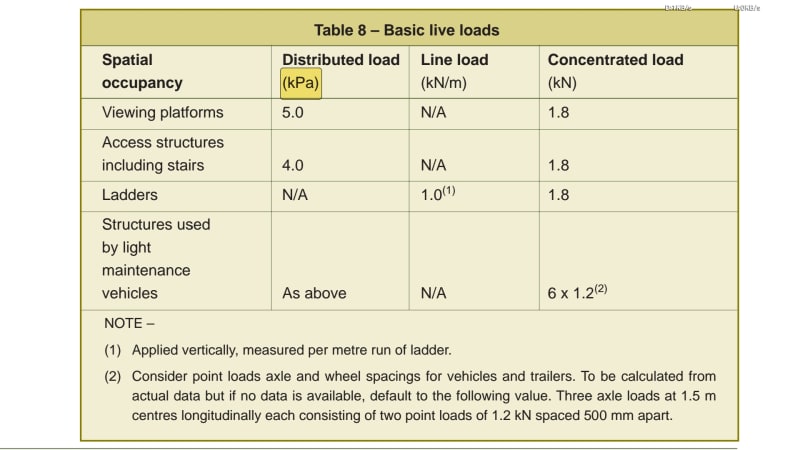

Australian Standard AS 2156 is for walking trails if you're interested in a directly-relevant but foreign standard. Loading is given according to a classification system.
Classes 1 & 2 = 5 kPa (100psf). Frequent encounters with others and moderate/high level of facilities (a popular and developed track essentially).
Classes 3 & 4 = 4 kPa for viewing areas and 3 kPa for the access ways. Occasional encounters with others, infrequent facilities, moderate fitness but no experience in bushwalking necessary.
Class 5 = 3 kPa viewing area and 2 kPa access ways. Somewhat remote, you won't come across many other people, should have bushwalking and navigating experience.
No reduction for large supported area in any case.
Think carefully before applying Class 5 in USA 48 states. Australia is the same size but <10% population so we have a lot more cases where this would apply.

I forgotten about this until somebody mentioned the Australian standard: Link. it's pretty handy even if you need to tweak the lumber products abit for North American use. I've had a couple of instances where I've been able to get in early on this kind of project and convince the design team to just do it like the manual shows. Pretty dreamy from a few perspective. Of course, folks often have their own ideas that take things in a different direction.
