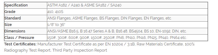

Simply put, I have a compressor casing that needs a weld neck flange. Construction is per ASME VIII. THe casing is 410 CA6NM. I was looking thru our company's specs and noticed we don't have any martensitic stainless weld neck flanges called out (I was looking for 410). I start looking at ASME VIII and it calls out B16.5 for flanges. Then I look around at vendors that produce B16.5 flanges and realize they call out materials using ASTM A182 (among other mat'l specs). A182 has UNS 410 as an option, however 410 doesn't seem to be among vendors options.
So.. what's going on here and what am I missing. It seems 410 doesn't meet a spec, but I'm not sure which one. I don't have access to ASME B16.5. Does this have a section detailing acceptable materials? If so, is 410 not allowed?

awhicker84, I can't confirm the to the latest edition B16.5, but in older editions 410 materials were not within the scope. This means B16.5 contained no pressure-temperature ratings that could be applied to flanges of 410 materials.
A B16.5 pattern flange of 410 material, if such existed, would have to have the P-T rating confirmed by other means, such as perhaps Sec VIII, Div 1, Appendix 2.

Thanks Mike.
That's what I was shooting for. ASTM A182 does reference ASME BPVC IX. I think we are basically saying that other materials are "pre-approved", while 410 requires some additional calculations.

I'll have to dig deeper. I was also surprised to see IX called out, but it made me feel more comfortable that ASME was mentioned in the spec. I saw one vendor site refer to their flanges as thus:
