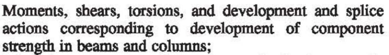

Search of the document turned up this definition:-
The equivalent table in ASCE 41-13 had a V term that was defined as "the design shear force calculated using limit-state analysis procedures in accordance with Section 10.4.2.4.1". Section 10.4.2.4.1 says in part:

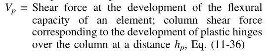

This is consistent with the definition of VyE that Agent666 found (in the commentary of ASCE 41-17). They can't keep their symbols consistent, but if you look up Vp in Chapter 1 of ASCE 41-17, it gives a pretty good definition:
The other thing I have wondered is what axial load should be applied to the column when determining the plastic moment of the column, which in turn determines the plastic shear. Since you are comparing VyE to VcolOE and VcolOE is calculated based on axial compression only from gravity loads, that is what I use to determine my plastic shear. Below is a snip from 10.4.2.3.1:
