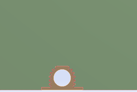

Hi all,
I think it's better to explain with this example:
It's also a 2D analysis, in on the bottom there is a resistor where there's applied a tension, the rectangle around is environment that i need to study.
Resistor material is alluminium, and environment is air.
I have a bonded contact.
I need to see in time what temperature i'll have on some points above resistor.

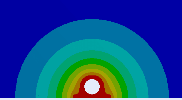

This is the result in temperature:
Why according to you it doesn't recognize that Y axis is vertical, so i have a different heat sink between Y and X axis?
Thank you
Regards
This would require conjugate heat transfer analysis (in CFD solver) to properly account for heat exchange between resistor and air. I think that you still use a model where heat transfer in air domain is via conduction while it should be via natural convection mainly (in the air conduction will happen too though).
Unfortunately i don't have license for CFD, I just have Mechanical Premium. :(
