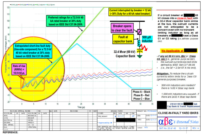

Circuit breaker class C2 (formerly "Definite Purpose Breakers") are rated per IEEE Std C37.09a & IEC Std 62271-100 to withstand a wide range of cap-bank interruptions without synchronous control.
Beware that the trend in the power industry is moving away from using insertion resistor due to high O&M cost and reliability concerns.
Below is an illustration of transient analysis of a Class C2 Breaker rate for 72.5 kV(69 kV) for switching a single 32.4 Mvar cap-bank.

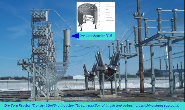

Cranky: dry core reactors (Transient Limiting Inductors - TLI) are available for HV Transmission system up to 345 kV and expected to be available shortly at 500 kV. TRENCH, GE and ABB could provide dry core reactors.
Awareness of Drawbacks of Installing Cap Bank Reactors (TLI):
Below is an example of dry core reactor (Transient Limiting Inductor) for a 230 cap bank application.
