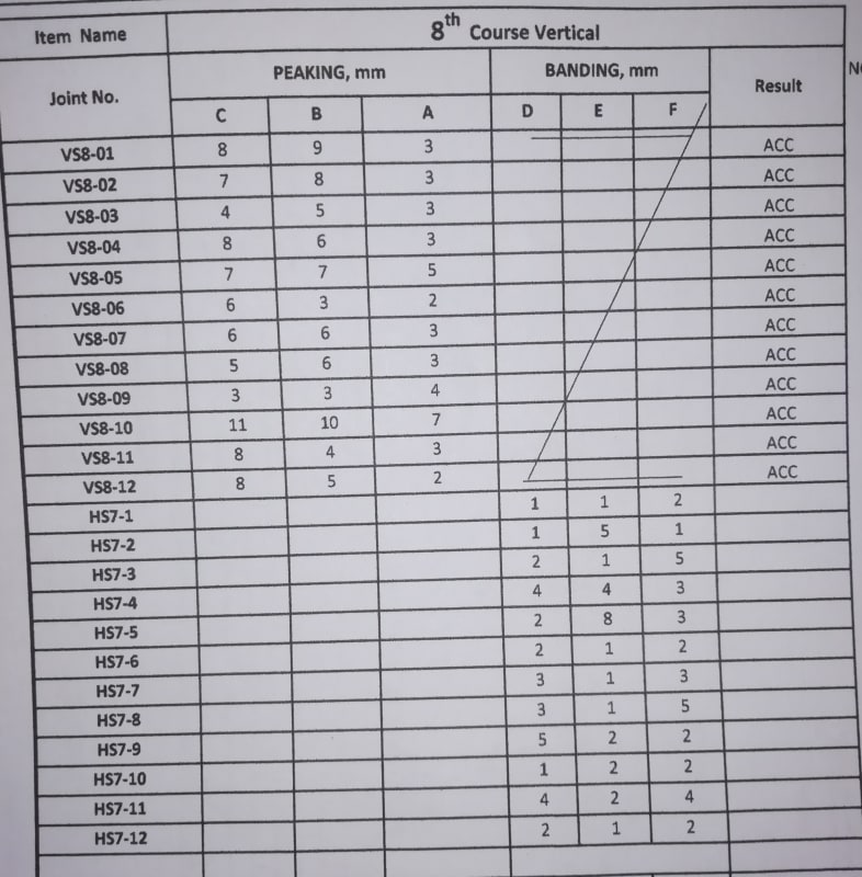

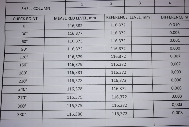

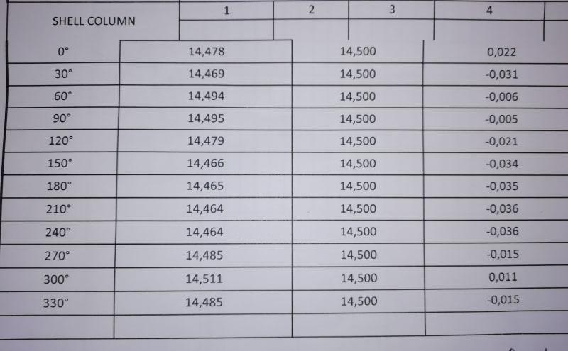

thank you all for replying to my post
i went to check this morning and i found that the roof is seated on 3 different places : shell,the weld between the top angle and the shell , and few millimiters into the top angle , it's very uneven
you'll find in the attached photo the readings of roundness , plumbnes...etc.
Mr JStephen, the roundness is -35 mm meaning the shell is -15 mm from the toelrance which is 19mm.
this what strucks me odd , the roof should have had more than enough space to be seated on the top angle.
my concern is that the roof was not constructed properly. meaning diameter and curvature are not respected
is there any tolerance for that .
thank you in advance for your precious insight into this issue
