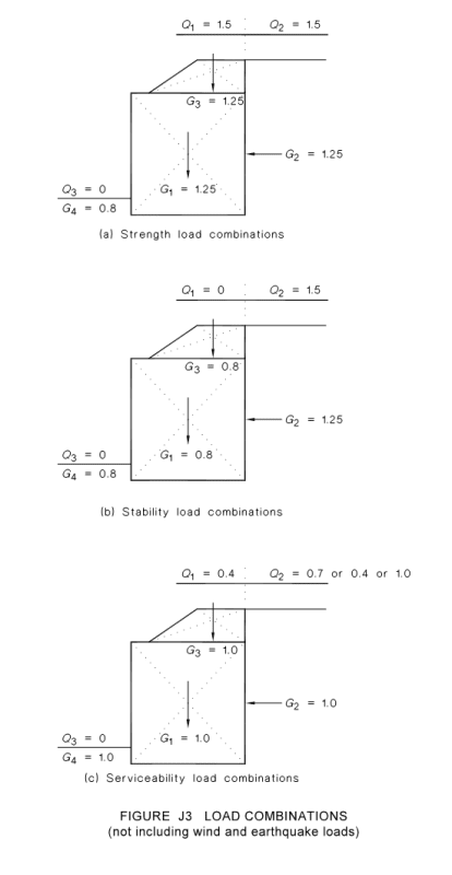

Hello Everyone,
I do checking for stability of foundation as per 0.9G (Sec. 4.2.1 AS 1170.0). Now, I will be designing a simple retaining wall and I thought that the load combination at section 4.2.1(b) can be used since there's a lot of destabilization force present. But my checker told me to just use 0.9G for stability.
Question, when are we to use the section a and section b of for this?
Thank you very much

The wording of the clause is confusing at best. The commentary explains it clearly if you can get a copy.
Part A (0.9G) applies to *parts* of the dead load that are stabilising the structure. Part B (1.2G) applies to parts of the dead load that are destabilising.
The example in the commentary is a cantilever beam. The cantilever part is destabilising so the load on it is 1.2G + 1.5Q. The backspan is stabilising so the load on it is 0.9G.

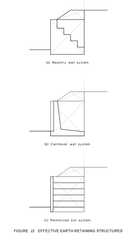

If you have access to AS 4678, it does a pretty good job of explaining the general concept of the separate effects of stabilising/destabilising loads with respect to retaining structures, see screenshots below.
Though the rest of the standard in the way it asks you to meddle with the basic properties before calculating fundamental geotechnical properties always seemed a bit of a weird way to go about things.
Ignore the different load factors in your case, but keep in mind AS4678 is able to be used to justify the use of an 'ultimate limit state method' as explained in the commentary to AS/NZS1170.0 so that you can apply a load factor of 1.0 (see 4.2.3(f)(i)), this can justify a lower than 1.5 factor on the lateral earth pressure in some cases.
