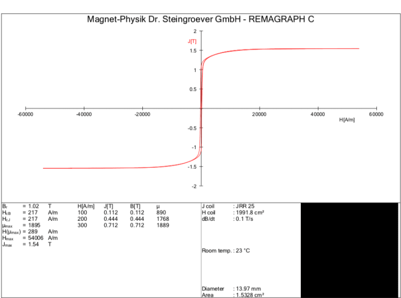

What is the ideal coercive force for fully magnetically annealed bars between diameters 6.35mm to 17mm for type 2 Alloy?
Also, is there a way to reduce the saturation induction of the bars through some changes in annealing? My values are always in the range of 0.9 to 1.1 Tesla
ASTM A838 specifies Hc max < 3.4 Oe, ideally 1.8Oe, or even 1.6 Oe (if low is ideal for your application).
saturation induction is insensitive to structure, one can hardly change saturation by heat treatment. However when you got .9-1.0 T, material was not saturated, you should have got 1.4 T or so when fully saturated. Normally applications ask for high saturation. when you ask for a lower induction at some H level, that means you are asking for a lower permeability at that H level, this could be accomplished by annealing, e.g. decrease anneal temperature/time. Or, do not do magnetic anneal, instead use as mill annealed condition.

The application is to make plungers for solenoid valves. However we only produce soft magnetic bars and it is machined by the user. The user needs the bars to have high permeability and low coercivity and the Br needs to maintained at 0.9T max. To give you an example, please see the attached BH curve.

Remanence occurs after saturating, and the field is lowered, apart from the changed reluctance of the magnetic circuit due to the plunger being in a new position, so Hi-Remanence is a function of adequate coercivity and low-remanence of the plunger in its latched state...
You see measured remanence of the core material goes to zero with zero coercivity....and is high with high coercivity.
Sounds like poorly dimensioned design, as machining tends to increase the coercivity, and your customers magnetic flux circuit is inadequate.
Sorry I was talking about Residual Induction(Remanence) not Saturation Induction, my bad.
The Saturation Induction is usually close to 1.5T.
If the Remanence is high it causes "sticking" of the plunger which is why we need it to be below 0.9T while the required Permeability should be around 1700.
We are able to achieve low remanence when permeability is below 1300. But low permeability leads to Higher coercive force.

It is hard to decrease remanence while still remaining high permeability and low cocercivity! you don't have much to do on material side unless you can change your design.
Decrease L/R ratio (shorten length or enlarge diameter or both) will increase de-mag factor, so lower remanence.

The properties are achieved by magnetic annealing but they change drastically when we perform grinding or straightening after that.(For tolerance and surface finish)
And this problem is prevalent in smaller diameters only, around 10mm and lower. There isn't much that can be done with the chemistry. Is there any way to maintain the properties after annealing?
