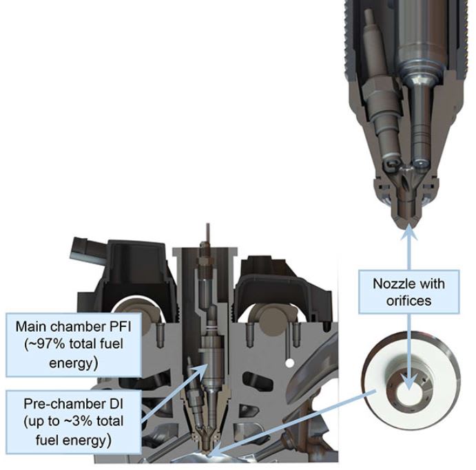

It's going to be very interesting to see how Mahle packages the injector and spark plug into an affordable engine that isn't serviced after every use (see picture below taken from the article at The point of all these alternate ignition systems is to allow operation with a lean mixture which would, in turn, allow designers to eliminate throttling in gasoline spark ignition engines. This objective is similar to that of Homogeneous Charge Compression Ignition (HCCI) without the control headaches. Mazda's spark ignited HCCI (SkyActiv-X) seems much simpler than Mahle's jet ignition, though it does require charge stratification to work. The purest "spark" solution would be a laser with a prismatic aperture into the chamber allowing simultaneous ignition in multiple locations around its volume. The best solution overall, however, remains HCCI in my opinion.
