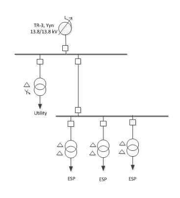

Recently there was single line to ground fault in my plant, below is the current based on the actual record on related relays:
* TR1 and TR2 LV winding are connected to ground with low resistance NGR (1000A
* Neutral point of generators are connected to ground with high resistance NGR (10A)
* TR3 is single winding autotransformer with no tertiary winding, the neutral point is solid grounded
Based on coordination relay study on easy power, it supposed to be no current flow at feeder 7A Bus B during fault at feeder 1B's downstream. But actually there is zero sequence current flow at that feeder which caused breaker 7B tripped by 50N relay.
note: in simulation I modeled TR-3 with two winding Yyn Transformer
Is it wrong to modeled the transformer (TR3) with two winding Yyn Transformer? because there is no single winding autotransformer in easy power.
I modeled it with two winding Yyn Transformer because the zero sequence circuit are the same.
Please advise

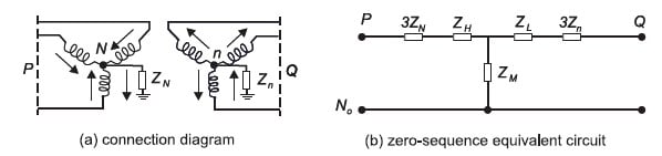

I'm guessing that TR3 may have been modeled with a three legged core.
Try another model with a wye/delta transformer in place of TR3.
I think that you will see a heavy contribution to the fault.
A transformer with a three legged core has a phantom delta effect that may have caused your current.
Will Easy Power let you choose between a three lagged core\and a five legged core?
If so try modeling TR3 as both a three legged core and as a five legged core and see if there is a difference.

I got your point, three leg core transformer will create additional ground path due to Zm.
So, there will be current contribution from this feeder to the fault.
If I want to omit current contribution from this feeder, what should I do? Remove neutral to ground connection of this transformer?

Does Load 7 include any additional transformers? If so, please describe.
Yes, there are Dy and Dd transformers (delta on 13.8 kV side)
And you’re absolutely positive that none of them are actually grounded wye on the high side and delta on the low side?
Yes, I'm sure.

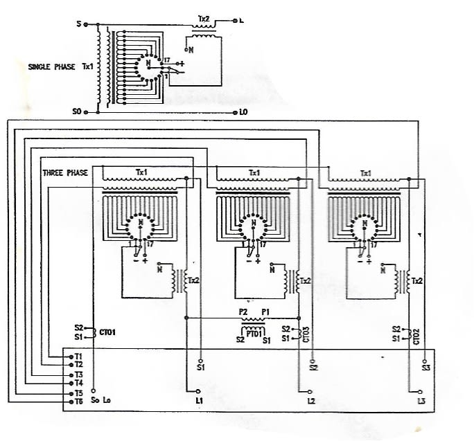

what is the purpose of 13.8/13.8kV T3 Auto
What about the possibility of a delta tertiary in TR3? Could be buried with no external bushings, but its presence alone would be important even if not connected to anything.
@bholas Bus F is quite far from Bus B (30000 ft), so it is needed to boost the voltage.
@davidbeach TR3 connection is like this, I thinks there is no tertiary winding in TR3

Thanks David & Bill, I had always thought that this transformer have no tertiary winding. All study always model this transformer as Yyn transformer with no tertiary winding.
I've checked the old drawing and I found that actually the T1-T6 terminals are delta connected. But I'll check to the plant to make sure how the actual connection is.
