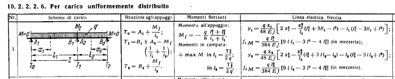

Hi all,
Is any Italian-speaking engineer able to explain what the letters A1, B1 and A2,B2 represent in the attached diagram?
I can follow all the other headings but it's just those that fox me.
Thanks.
I don't speak Italian, but I don't think you've included enough information for this to matter. I would guess they mean the end reactions calculated as if there were two simple span beams instead of one contiuous one. You could check this against the standard formulas for continuous beams over stiff supports.
going from the formulas for the Ti's, looks like the A,B's are the simple span end reactions combined with the reactions caused by the interior moment, MI:
A1 = simple span reaction at the left end of the first span
B1 = simple span reaction at the right end of the first span
A2 = simple span reaction at the left end of the second span
B2 = simple span reaction at the right end of the second span

yes, midspan reaction = B1+A2
Many thanks all, cleared it for me!
It'me that I posted that figure. I asked if it was necessary any translation, but someone replied that it was not necessary. Any way all above answers are correct. I here attached the complete set of formulas

It looks like a pretty good listing of loadings for beams. Does anyone have an idea from what reference text this came from ?
original book : "Stahl im hochbau" - Verlag Stahleisen - Dusseldorf - 1969 (but 1st edition 1935)
my copy (word by word translation in Italian) : "L'acciaio nelle costruzioni" - ediz. Cremonese - 1973 (out of print - few copies available on line)
