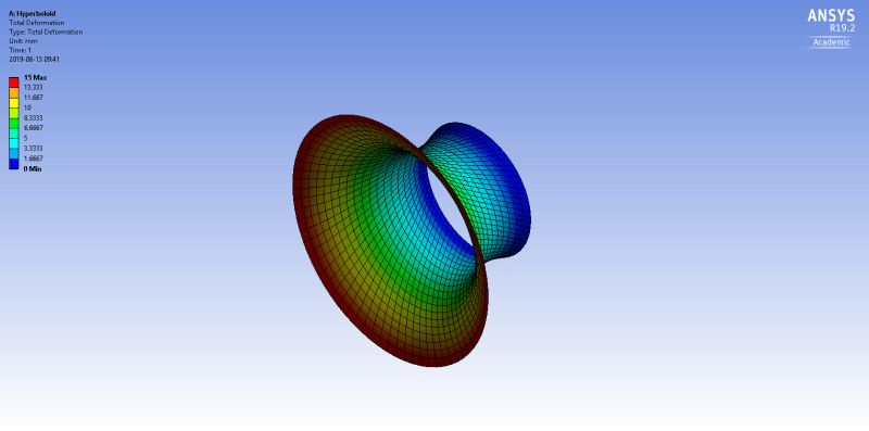

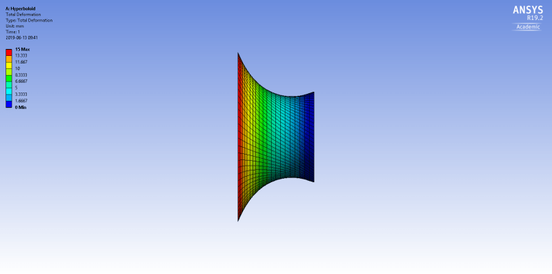

Hi All,
I have a cylindrical rubber piece that I want to twist into a hyperboloid.
I tried fixing a circular edge, and applying a rotational displacement of 10° to the other edge but
the deformation seems quite unrealistic. I would expect the necking to happen about halfway.
Also the required rotation is 30 deg, but solution won't converge.
Any tips on how to set up this problem is greatly appreciated.

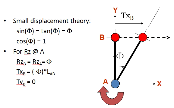

Maybe you are trying to calculate problem in linear static. Linear assumption (small displacements and small rotations) give large errors when you are use rigid elements (RBE2 or RBE3 you use to apply load or fix other end) and rotation.
Try to on nonlinear solution.

You need to also restrain the left hand circular edge in Z and radial leaving only rotational free. Does ANSYS not have cylindrical coordinate systems ? Would seem the ideal use of such.
Like this:
Hi rother,
I inserted a cylindrical coordinate system and set axial and radial displacement to 0. Rotation set to 15 mm.
It sure helped, at least now the necking is happening in the middle, as expected.

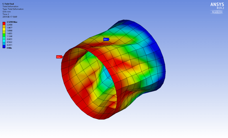

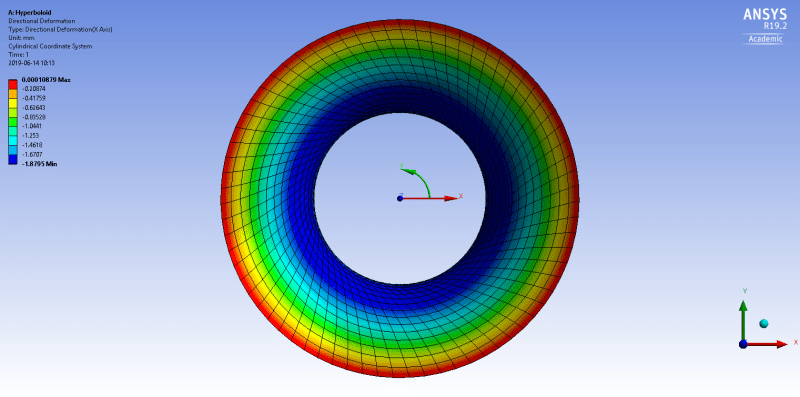

Still when I look at the deformed shape (true scale) the edge expands out in radial direction:
Any ideas why this might be happening?
Also in real life when twisting the rubber sheet overlapping folds start to appear.
I was able to reproduce this in ANSYS by tweaking dimensions of cylinder and playing with mesh settings
but it seems a bit inconsistent. I cannot get the right result every time.

I would check the value for the radial displacement (directional deformation in the x direction). The scaled plot can be misleading.
I checked the radial displacement and indeed it's really small at the top edge.
The plot scale was set 1.0 (True scale) so maybe just a visualization artifact of ANSYS?
Seems that the program is using the total deformation value to visualize the scaling. You can also use remote displacement boundary condition if you want to define the angle.

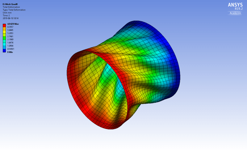

Here's the latest result where folds appear.
I added a step to pre-tension the membrane in axial direction before twisting.
Really hard to find convergence with a refined mesh or twist angle greater than 15°

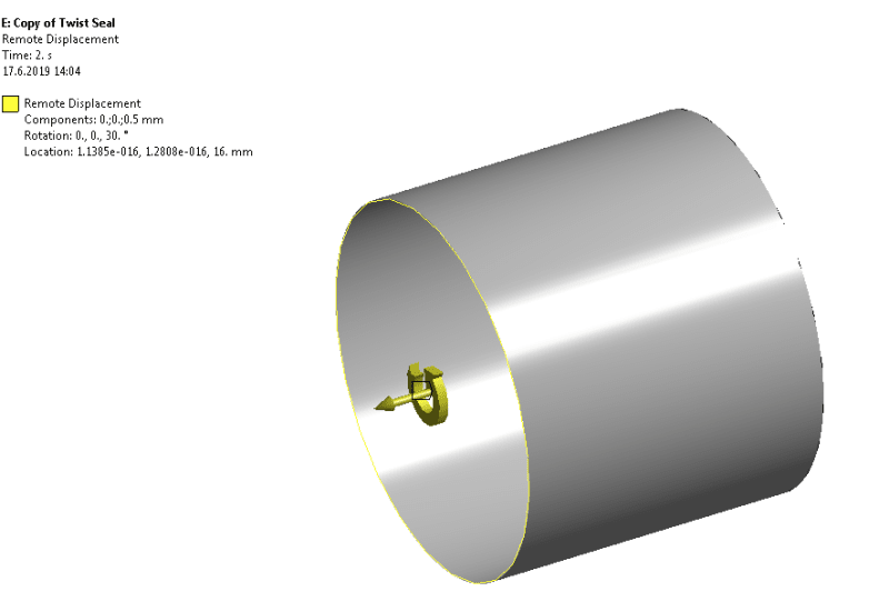

I am getting the analysis to converge to 30 degrees using linear tets and element size 1mm.
By the way, check the location of the reference node of the remote displacement boundary condition.
In this case the location does not matter though.

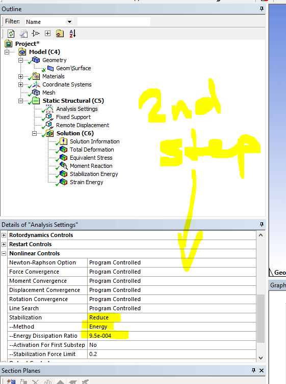

A couple of things that will help.
-Use QUAD8 elements, since this is a thin body (higher order QUADS, to capture curvature better, ..). You can set that in mesh and element order (set to quadratic).
-Use stabilisation since the structure undergoes some form of instability (as seen in your image above).
-Move your remote point location in z top about the opposite edge (Z= ~0.0157 m).
With that and with more initial steps (100)+maximum steps (1000) for step 2, it is fine (solves for 32 degrees) just make sure that the stabilisation energy is not too high in the end (should be small compared to the elastic energy).
