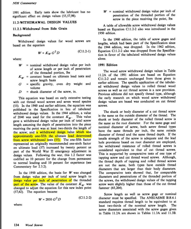

I recently went down this rabbit hole and didn't come back with much satisfactory. I was trying to reverse engineer the actual screw rupture/failure loads from the NDS design formula for withdrawal.
The best I found was the NDS commentary which seems to indicate that withdrawal design values were 1/5 the rupture test values (50s era testing). The commentary on more recent NDS editions doesn't seem to clearly indicate if this factor was maintained.
A safety factor of 5 seems to be pretty common for fasteners and structural connectors I think. I'm pretty sure Simpson connectors, for example, are tested/calculated at FOS of 5.
